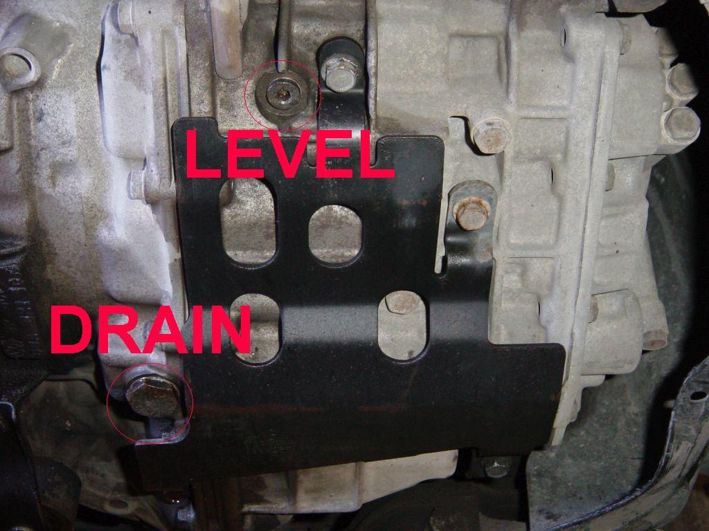

So bob, vere ist der plug? Topside or do we have to get to it from underneath the car?

The 5mm hex plug is on the bottom of the gearbox.
Page 29 and 30 of the TSB XT307-S941 describes how to top-up the fluid level.
It is the SAME gearbox and filling procedure for the VW Jettas with the 09A JF506E JATCO gearbox.
Since there are hundreds of thousands of VW Jettas with this trans it might be easier to interweb search the procedure for that.
You don't have to discard the plug and sealing washer if you don't have a new one, I re-use them at least once if I need to. Any generic aluminum or copper washer will reseal the plug.
bob

Thanks Bob. I wish Jaguar had put a diagram along with the filling instructions. 5mm hex plug - I'll look for one the next time I'm under the car.

Here is some info for the JATCO gearbox. It might be for VW or just generic??
bob

Here is a pic of a VW Jetta I worked on today. Same JATCO gearbox.

Ah....now we're talkin'.
