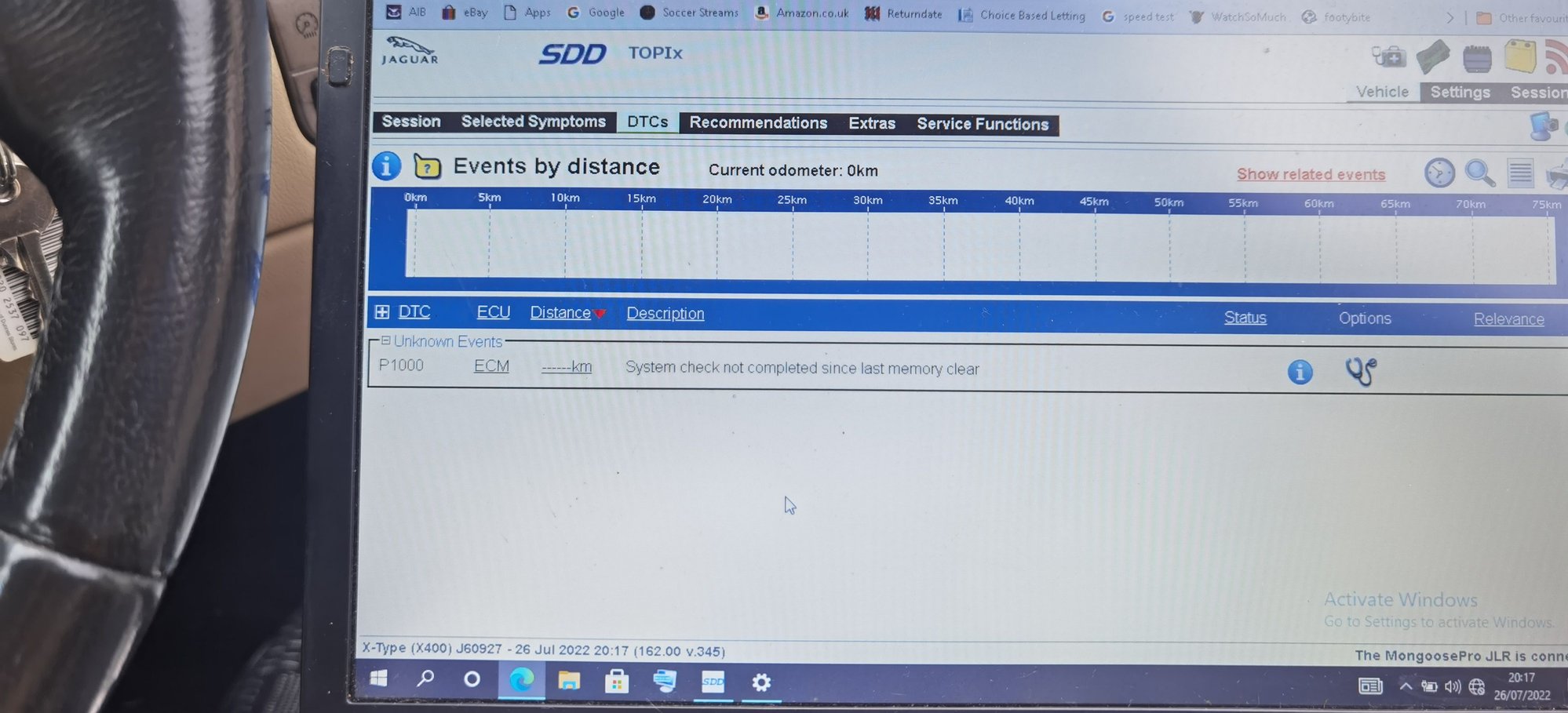

The reader I usually use is the iCarsoft reader.
But I also had the SSD software (until my laptop died last month) and that was the same when I ran scans last year, no other codes, except the P1000 (see screenshot below). Unless I was reading it wrong or something..
But I did run the EGR test too, where you have to let the car warm up and then keep the revs at a particular level for a few minutes, and I think that also said there was a problem too, but it never told me what the problem was. I think it, like, failed the 4th test of 6 or something like that, I can't remember exactly.

gijoe, if your SDD is not picking up anything, then I would give the car a good bill of health. In my mind that really only leaves one other problem, you have a bad instrument cluster and that it is somehow failed to trigger the CEL every once in awhile, driving you bonkers. That is the only othe answer I can tell you.
