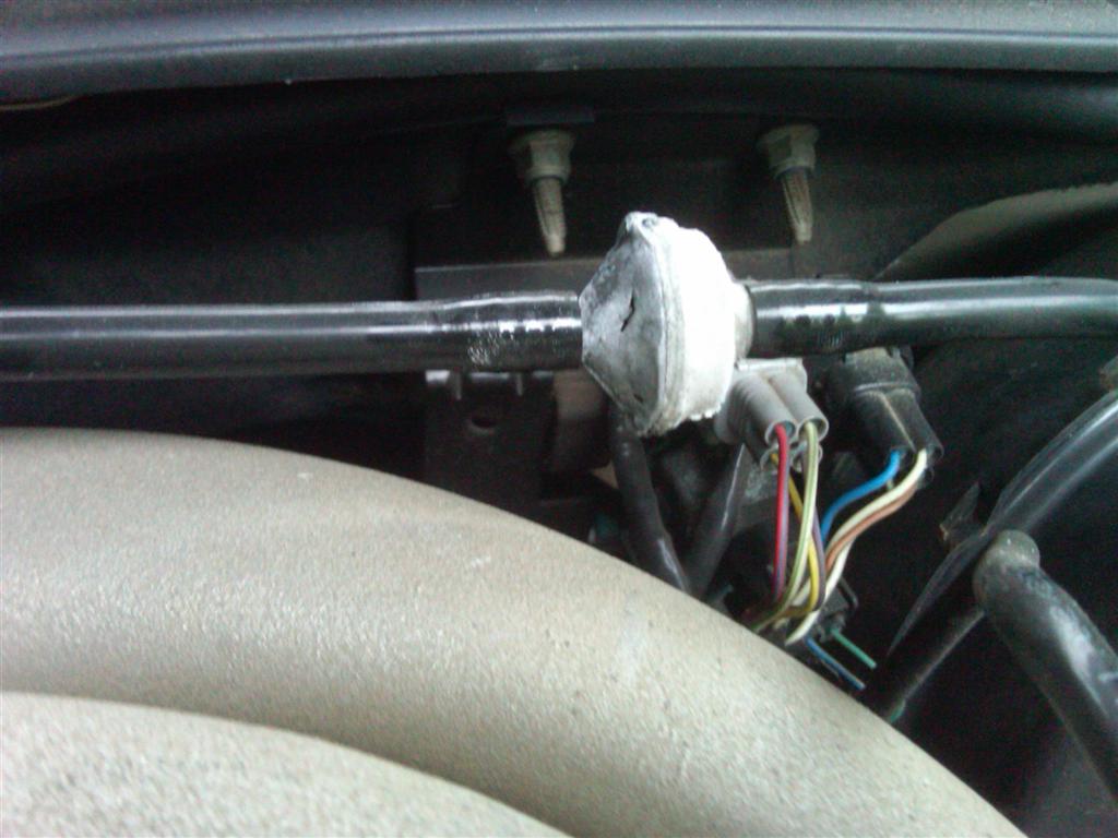

The check engine light came on today on my way home from work. I stopped off at autozone to have them pull the code. They tried it a couple times and their little device just came back with an error. So I'm not sure what the error code is. That being said I have done a little searching trying to determine what some of the normal CEL causes are on this car. I have seen a couple items related to PVC hoses and such. I took a look at all the hoses running to and from the throttle body and noticed something interesting that if it isn't causing the CEL is probably something else that needs to be addressed and I need help identifying it. The thing is in-between the vac line that runs from the top of the throttle body to I believe is the brake booster. It started to disintegrate when i touched it so I spun it over in the line to notice it was cracked and falling apart. Attached should be 2 photos of the item in question.
Any help identifying the part and also suggestions on things to check for the CEL are greatly appreciated.

DZTT, odds are, that is your smoking gun. That is a common failure item of our cars. Fortunately, that is also a cheap part to replace. Unfortunately, you can only get it through the dealership or possibly through Ken@britishparts.com. That is the brake booster vacuum line/check valve (the check valve is the bulge in the center of the line). Atleast for the moment, I would try putting some duct tape over the check valve to try and seal up the leak for the moment. That should get you through until the new part arrives. I would also remove the engine cover and check the vacuum line running from the air box to the intake. If the brake booster line is failing on you, it is possible that one is not far behind and if you are placing an order, might as well knock out 2 birds with one stone. But, inspect it first. If you have an upgraded hose, it will have a bunch of ridges on it. If you have a smooth hose, then you have the old style that is prone to splitting on the underneath side, leading to vacuum leaks/check engine lights.

That has got to be the issue. Just checked with the car running and I can hear the air leak from the valve. I also have the smooth type hose going from the air box. Guess i'll replace them both while I'm at it. Hopefully that fixes it. Once the hoses are replaced is there an easy way to clear the codes?
Anyone by chance know part numbers so I can look the parts up online?

May as well do all three if you are ordering parts. IMT o-rings. Pull off the the top one and if you've also got a yellow o-ring in there it's going to leak soon. Dealer or Ken or Nalley on the site here will know all three parts very well.

Thanks for all the suggestions. I went ahead and picked up/ordered all the suggested parts at the dealer this morning just so I can do everything all at once. Hopefully this gets me all setup. Total cost with tax for everything was $114.
For future reference the part numbers are below:
C2S17552 - BRAKE BOOSTER VACUUM HOSE WITH CHECK VALVE
C2S40669 - INTAKE VALVE O-RING (2 required, new ones are green)
C2S40863 - BREATHER HOSE TO INTAKE MANIFOLD (newer style should be ribbed instead of smooth)

The ribbed breather hose at my dealer was $11. It actually goes from an elbow out of the top of the valve cover to the manifold. Easy fix and well worth it to do preventive maintenance. I was kicking myself for not changing mine before it failed. Make sure you clean up any oil laying about in the openings too.

DZTT, a word of caution. When removing the brake boost hose from the intake, push down on the little collar while pulling up on the hose! Hope I'm not too late...

Update: Ultra easy to fix all three of these items. It took about 20 min total for everything. Check engine light is now gone. Thanks mohrd for the heads up on removing the hose going to the intake.
