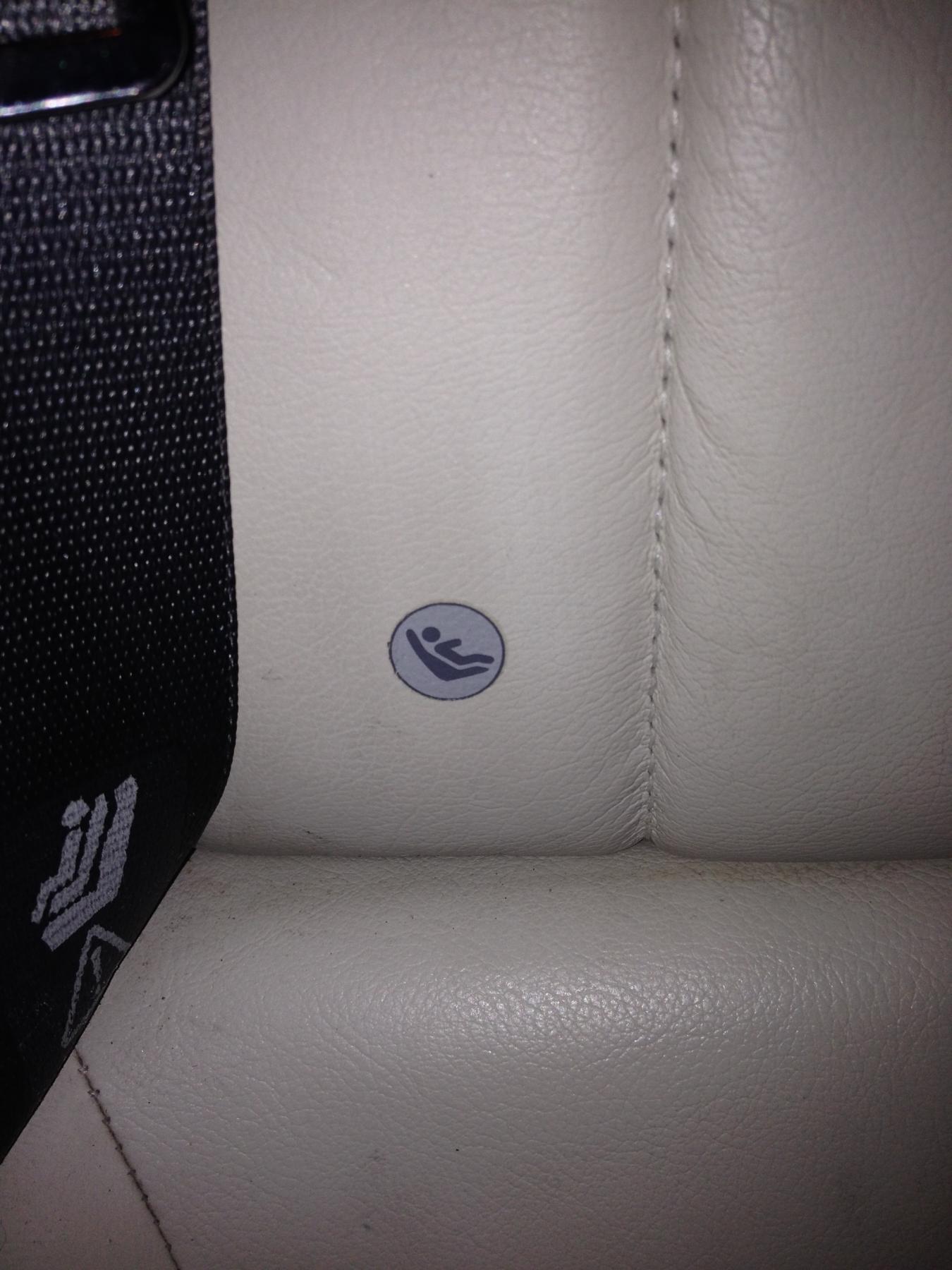

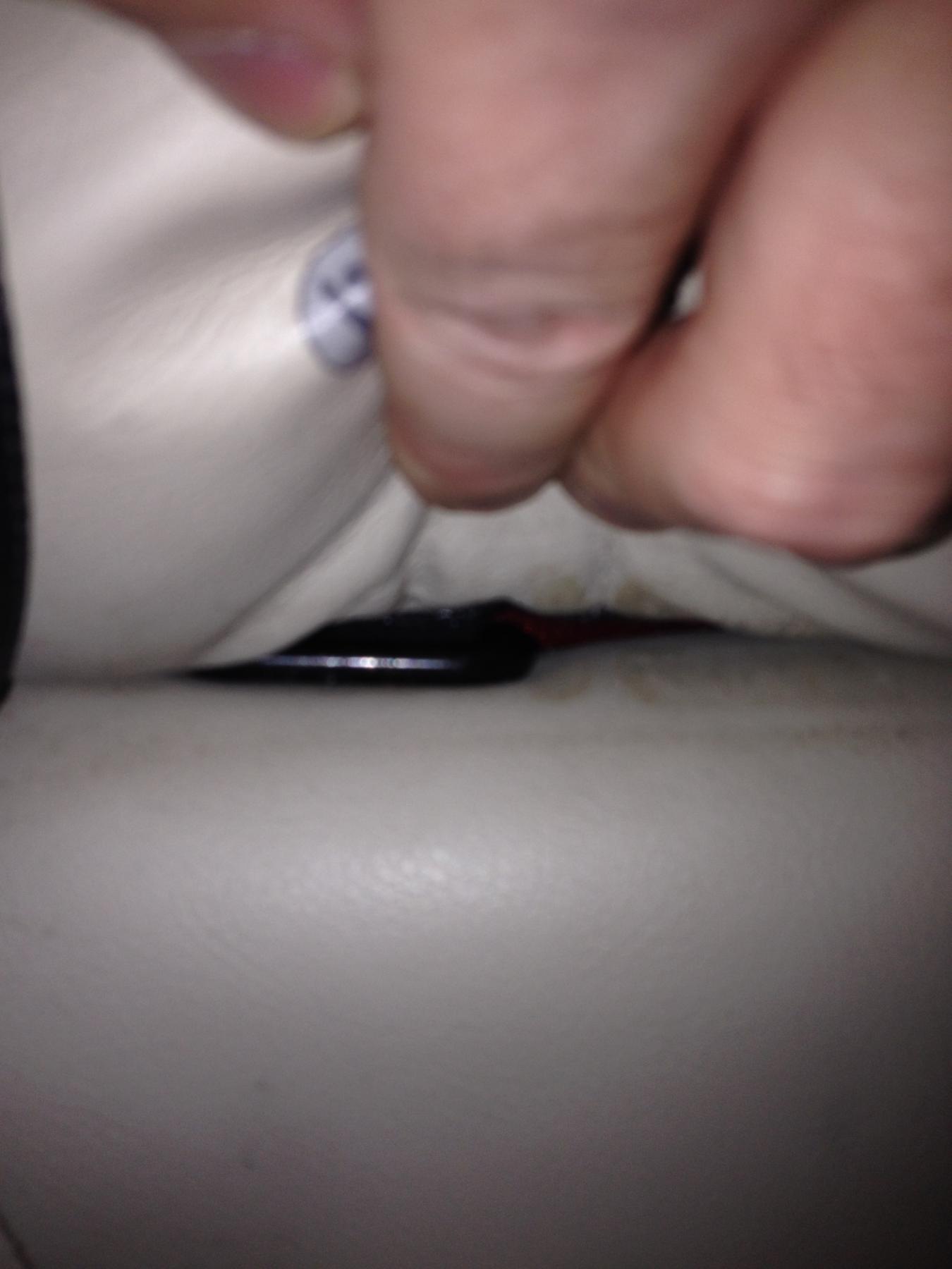

The brackets or loops are between the seat cushion and the back just below a label. if you have the top latch you should have the lower ones.
Attached Thumbnails Child Safety - Latch System-img_3952.jpg   Child Safety - Latch System-img_3953.jpg

Hi Paul,
Thank you for your response and info.
Nope, I neither have the label(s) or the Loops you show in your Photos.
Hmmm..... maybe they are not usually installed in LE Sports Models?

I do have the fold down option The brackets are bolted in position, if you pull up on the front corners of the back seat then once both sides are unlatched push back and lift the seat out and you will be able to see the mounting points of the bracket or hopefully the bracket itself.
Call your local wrecking yard and see if they have a jag they are breaking not sure if the s-type or the xj8 has the same bracket but you may get lucky.
