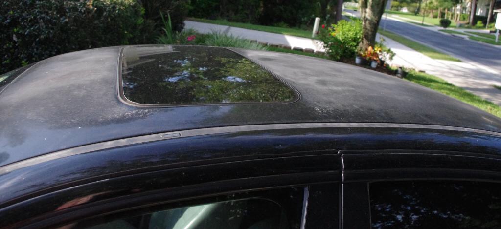

Welcome to Florida. My roof is trashed due to the clear coat burning away. There's a paint job in my future.

Got several chips in paint anyway.... Oh well - looks like new paint job is in my near future also...
