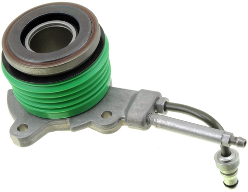

NBCat, I am not sure what you mean by rod. Looking at the slave all I can see is the boot and bearing.

Yes, the piston is covered by the boot and there is no adjustment. The rod I referred to is not part of this assembly or design.
From your description and the miles on the vehicle, it may need to have the gearbox/transaxle removed and the clutch assembly replaced. You may want to search this forum for advice on doing the job yourself if you have the knowledge and equipment. The JTIS manual should outline the procedures and steps.
