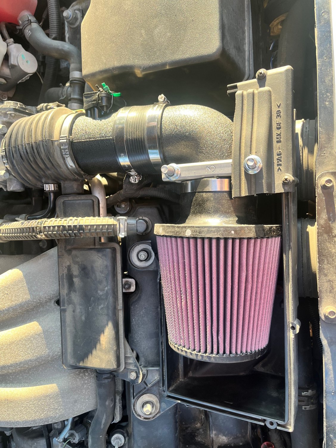

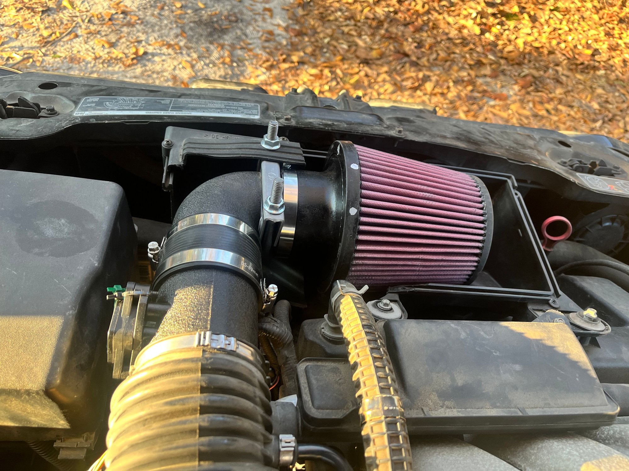

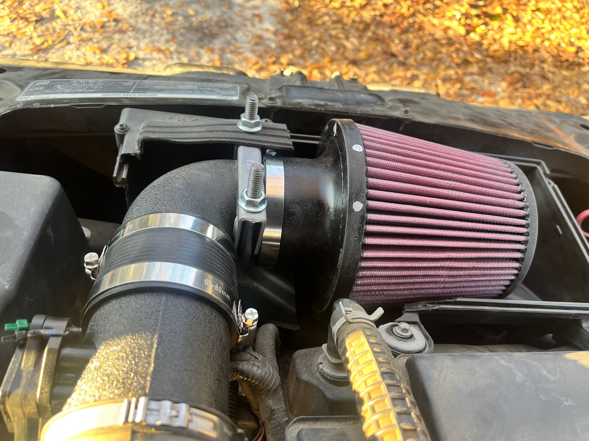

only posting to show those who want a hot air intake what parts to buy and how to mount it.
dont need 20 reasons why i shouldnt do this, i likely know as much as you
this is for the ricier sound to go with the adamesh performance mufflers.
the mufflers sounded great, but they sound better with a cold (hot) air intake.
parts used from advance auto all in stock.
