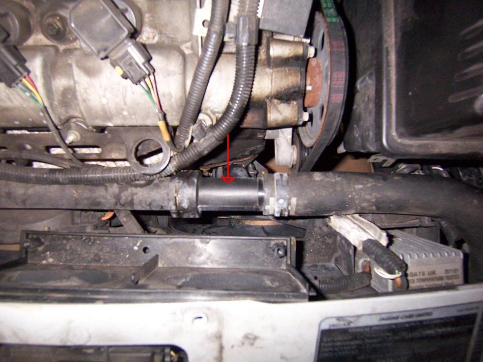

hi guys thanks for the help, i got the airbox off and instantly spotthe the problem, there is a platsic T which feeds down to some sort of valve which has a crack on the top of it... looks like an expensive piece. Does anyone know the name or part number so i can price it? For now i am gong to just sand it down and do a little JB fix on it untill i can get the proper piece. here is a picture of it

perhaps, gold plated, now that a jag peice lol

Matl, if it is just the T that is an issue, check out your local auto parts store. They may have a T that you can toss in there and get it fixed for pretty cheap ($5 for the T, another $5 in some hose clamps). Not sure how the bottom hose is attached, but should be a pretty straight forward fix. The only issue I see is that doing this repair, you will be draining out most of the coolant from the engine, so, a good burbing of the system will be required once all is said and done.

Thanks Thermo, When follwing the T down it is integrated with some type of a valve system and then also branches off to the block to feed coolant to what appears to maybe be the water pump? Idealy i should replace the whole setup but i think that will be pricey, for now the JB weld is seems to be holding. Other option would be to get a generec T and cut the existing part and reconnect with a piece of radiator tubing and clamps?
I'm not very familiar with burping the system? is there a specific method? Long ago on my acura i just ran it with the radiator cap off and squeezed all the hoses... haha.

Matl, to "burp" your Kitty (boy does that sound funny), you are supposed to fill the system up as much as you can. Then you are supposed to pinch off the hoses going to the heater core in the dash (only need to pinch 1 hose). Now, start up the car and let it come up to temp. This will force maximum flow through the block, pushing all the air out of the system. Then you can release the clamp, let some flow occur and then block it off. Pinch/unpinch the hose a few times and all should be good.
As for buying a new hose, I think one member here recently looked into it and that hose is like $330 (dealer part only). Oh, you want it installed, that is more. Granted, I am sure with a good parts guy, you can create your own hose for about $100 using a few hoses they have on the shelf and assembling it yourself with a plastic T.

matl, the hose can be had for $114.95+ s/h on partstrain.com, it is the oem part. Had the same exact problem during the summer. The fix was a pain, little space to work. The valve is the thermostat at the bottom, which comes with the hose(upper radiator).

Great guys thanks again for the help, for now the JB weld is holding like a champ. I will eventually fix it properly but i will go ahead and do the burp as you suggested. thanks

Here's a thought.... and i did this once tho' not on a Jag (a Triumph)... speak to a plumber... get a copper T section braised up out of a couple of pieces ( I be the average plumber would have a couple of scrap pieces of pipe close to the diameter you want just rolling around in the back of his truck).
