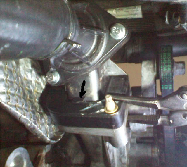

Well, I got 'er done and no leaks. I found it somewhat of a tough job but if you pay close attention to setting the clamps on the hoses and squaring them up so they seal well; you're done!
I tried like hell to get the C shaped plate in place but it would not fit. I think the new hose assembly covers the role of the C plate or, "re-enforcing plate". After fighting with it for 20 mins, I noticed a couple of tabs that stopped the C plate from settling into place. I ended up omitting it.
This pic is taken while laying under the car looking sky-wards. Not sure if you can see the nub in the pick, but I pointed it out.
The heavy flange above is where the C plate won't fit. However, it seemed to have an extra layer of 2mm thick plastic at the same location where the C plate goes. Who knows if this is meant for that same reinforcing? But I'm driving and my temp is steady..... I bought orange coolant at a Ford dealership. It happens to be right next door to the Jag/Land Rover dealership. I figured that the same coolant would be cheaper at the Ford dealer.

My worry is if I source the upper radiator hose and fit it myself, my bruv has stated I need to watch the torque level when I attach the reinforcemant plate to the alluminium block which I think is the water pump? I am stuck for the moment and would appreciate any advice? Thanks, Stu

I don't recall a torque spec for the flange in the pic just above. However, that would be nice to know, but make sure it's official because you don't want to over torque and crack or over stress the plastic flange.
Mine actually has a slow leak at that flange, but the other 2 connections are good. I re-tightened it once, but I'm just kind of living with it for now
My mechanic friend is right now under my car as I type this, I got the same assembly you got, hes having a hard time dealing with it, but right now looks like hes in the process of placing the new part.

I'd be curious to know if your mechanic was able to re-install this piece, or whether your car has it at all..thanks!

I will have a look when I get under the car again but, I have been busy. The plate was there before the garage did the fix, I hope it's still there. That is the daft thing I do when I'm busy, i SHOULD HAVE LOOKED! I used a new garage as I'm new to my area and I would like to think if they had an issue or couldn't refit that plate they should have said, but you never know!!! Good Luck!!! Stu
My car has it, and the thermostat assembly that I bought at my Jaguar dealer came already with the part installed on it, a band new C shape metal plate. I got the part for $112.00

I just got done doing this bought the OEM entire upper assembly include the thermostat and the part that attaches to the engine block. Apparently my C thingamabob did not come off and I didnt even see that when I attached the new one. The bolts were a pain to get to but no leaks and its been 4 days and some warm days in the desert.

Not to revive a long dead thread but I was reading this over before tackling my coolant leak over the weekend and I didn't see a successful explanation of "couple of tabs that stopped the C plate from settling into place". Looking at the part I removed I concluded the tabs need to be bent up and the C plate or reinforcing plate wedged underneath them. Those plastic tabs hold the plate in place during assembly. See picture.
