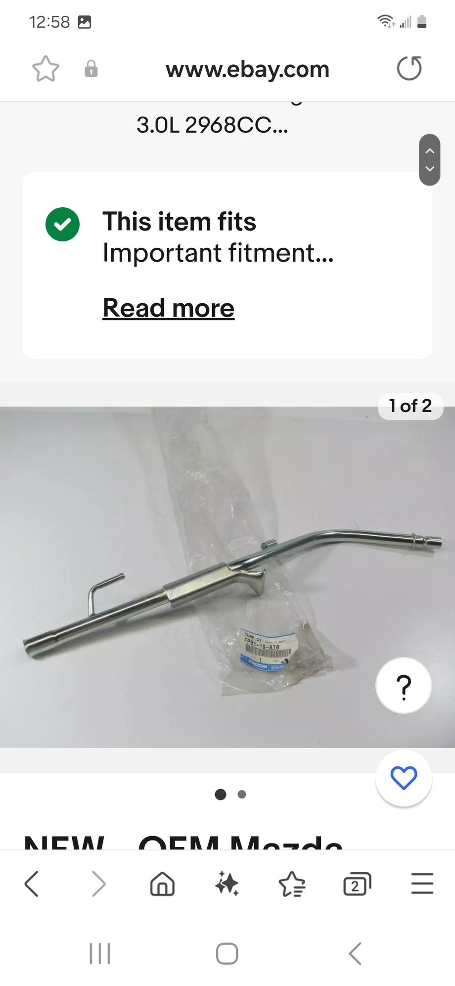

https://partsinn.lt/?oem=C2S12102
I wonder if because X and Mazda MPV use the same transmission if this would work on our X's. Then purchase a replacement dip stick as well.

It fits into the "fill" tube where the rubber bung is currently. Notice the flared end on the end that goes into the tube and snugs by compression there, as do many dip stick tubes on other vehicles.

It does not look like it comes with a dip stick.
I already produced my own DIY dipstick.
I guess if I wanted, I could create a longer DIY dip stick with a DIY tube sitting on the filler plug, so that no expensive tube from Mazda is required.

The dip stick is a separately purchasable item.
