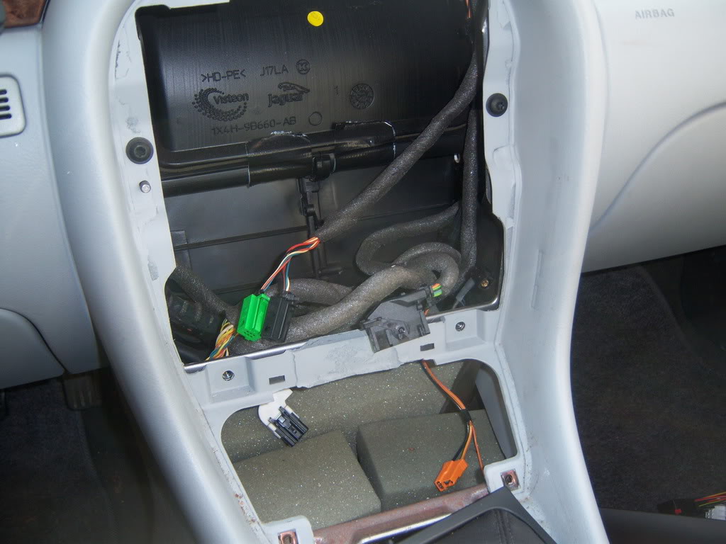

mine was 6.9 inches (177 mm). It is now sticking out til I find a replacement, so I'm looking at the depth to be around 6" or less...I might end up with a single din with motorized 7".

I was thinking that if I cut the ducting and then cover the hole with fiberglass shaped to allow the unit to be installed, providing I get an air tight seal around the edges then th AC should still work fine with maybe a little loss of power, hence the reason I would like to see where other people have gone this route.
If it's just space behind then I'll be fine what I'm afraid of is cutting away to find flaps etc behind the plastic.

We opened it up & there is flap in there. That is why I was hesitant to cut it.

Thanks for the info Rocky it wasn't what I wanted to hear but at least it will save me a world of pain..
