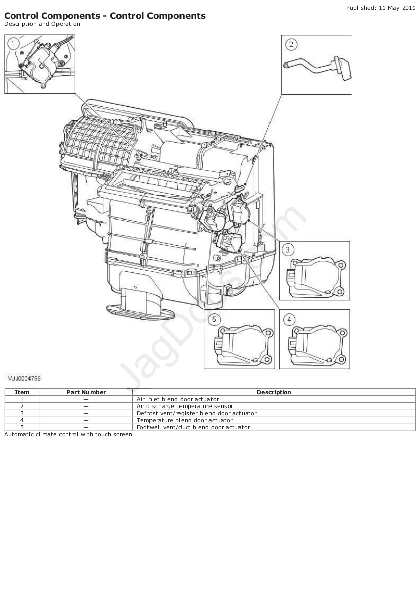

You can start here - Blender Door Troubleshoot link:
http://www.jagrepair.com/images/TSB/...or%20Loose.pdf
There is also this (click on to enlarge - click on again to zoom):
Actuator #3 controls the defrost door position.
Hope this helps a little..

If you read the link I posted it actually TELLS YOU, there are multiple actuators. So yes some can function while others do not.
