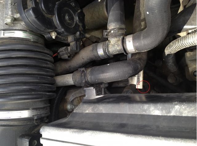

So I went to a guy I know, a master engineer. He too says "dont worry about it, I dont hear any serious problem, probably just an bad bearing." Needless to say I'm not satisfied. I bought a cheap stethoscope, had my friend give it light gas while I poked around around the pulleys and bearings, and didn't hear anything. So I put it on the intake manifold, doesn't sound like that sounds coming from the engine either. So I go lower, putting it on the metal case under the engine and bingo! Question is, did I just listen to the transmission or the transfer case?
Picture shows when I put the stethoscope.

sorry the picture didn't attach correctly

That red circle right there is not good news. That would be your trans. The transfer case is under the car. I would take it to a trans shop and have them look at it. How does the car shift? does the whine get louder or go away at Higher speeds?

The car shifts fine. The whine is mostly unaffected by the speed of the car, and only happens under throttle. It is, however, less noticeable at higher speeds. After at least a 15 minute drive the whine will be a bit noticeable car is idling in park. And you can hear it during that quick rev the engine creates when it's first started.
I was talking to a shop early that only does re manufacturing work on engines, transmissions, and transfer-cases. They can re manufacture the trans for under $2k, completely with a 3 year warranty. And since I'm sure they have to drop the transfer case out of the car to work on the transmission anyways, I can get the transfer case fluid changed.
I really just want to be certain what I'm getting done. I don't want to show up at this place and say "re-manufacture my transmission," to get it back and have had a whining transfer case all along.
