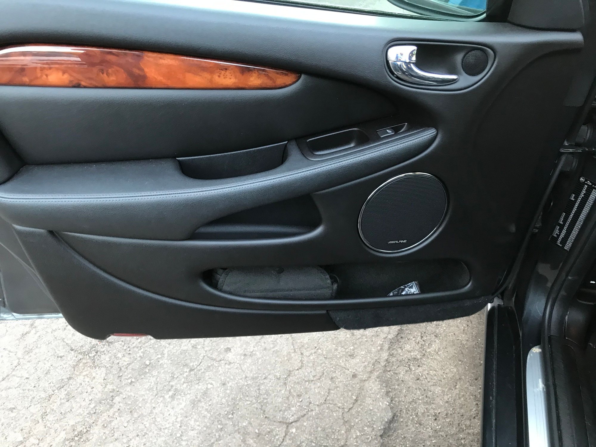

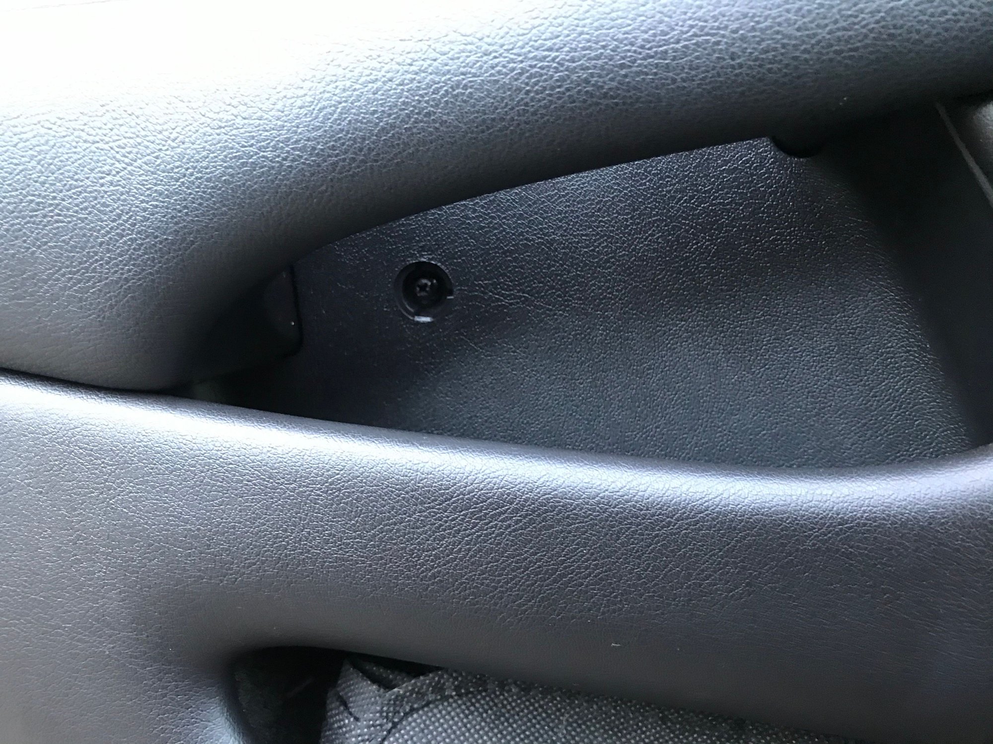

Hi I am looking to remove the door cards on my 2009 X Type I have found the two screws at the bottom and one in the centre but are there any others hidden as still appears to be fixed?
Removed this one and the two at the bottom of the door card
just want to check as don’t want to force it off if there are screws hidden that I can’t see?

I think that's all the screws. The card is held on with 10 or 15 plastic retaining clips. You need to get a pack before you start as some will break. They cost next to nothing. You will also need a large plastic pry-bar or a metal pry bar with some protection to avoid scratching things. Some force is required.
