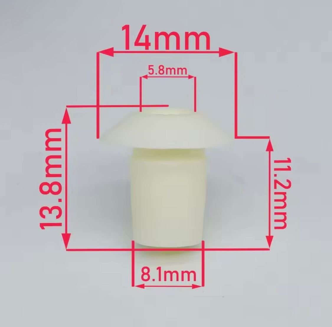

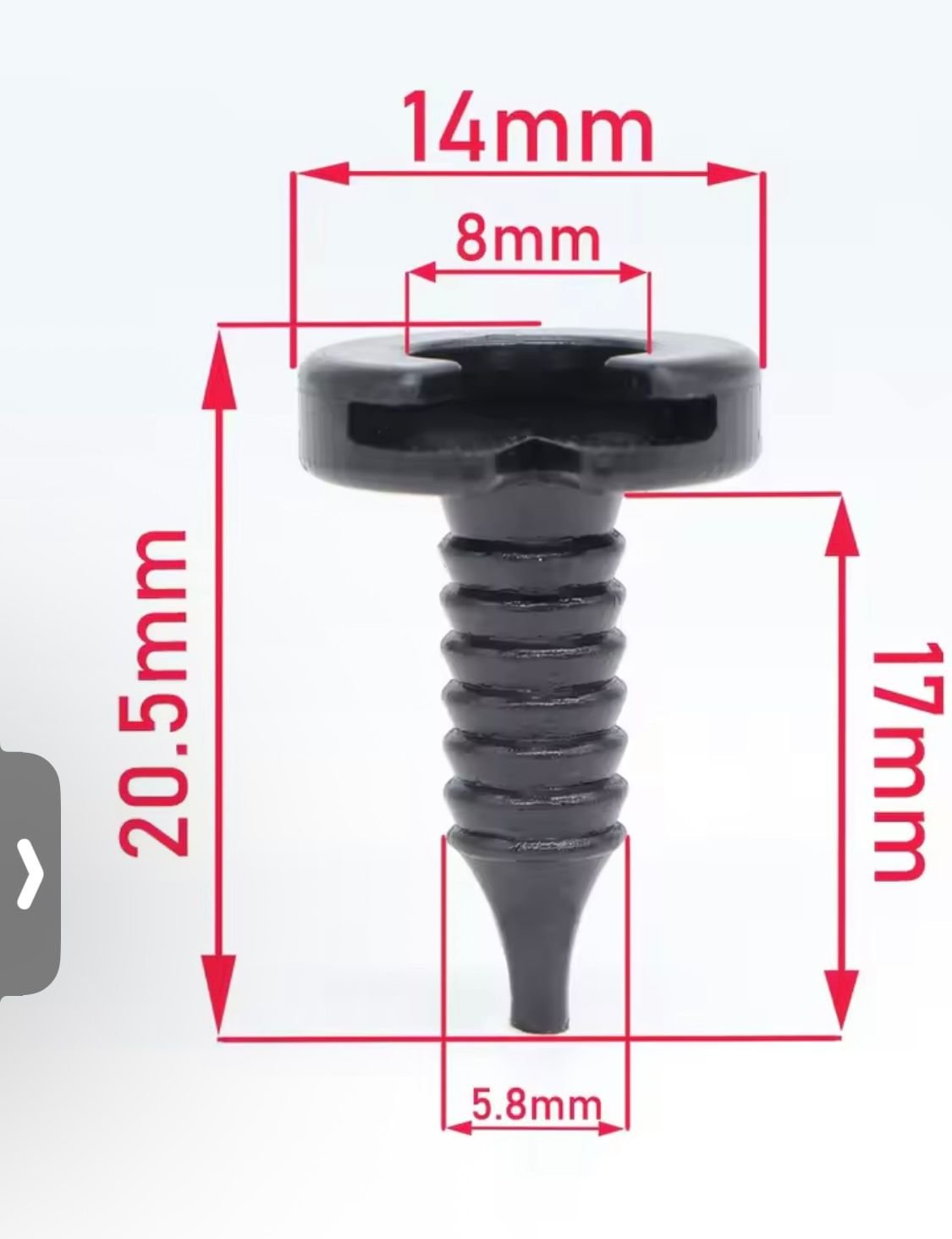

found the part, on the trusty X-type 2001 - 2010 (x400) Classic / Door Casing-front | Jaguar Land Rover Classic Parts site.
part 9 only available at ridiculous prices for plastic
Also parts for the green, pink and brown pins... who knows which one ones go where

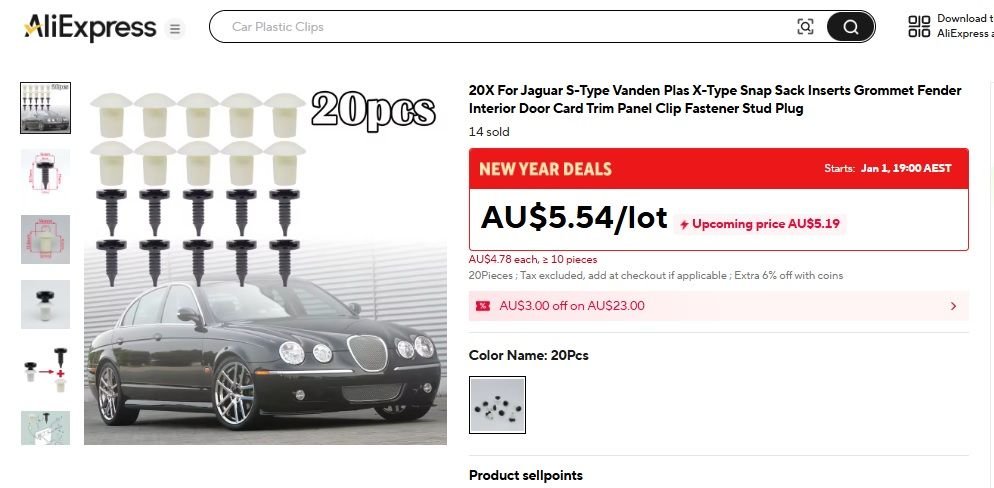

The sketch is not all too clear, but I think you may be able to find what you are looking for on Aliexpress & dead-cheap:
I looked on Aliexpress for "Jaguar X-Type door panel clips" and "Jaguar X-Type door inserts for panel",
And I found this:
https://www.aliexpress.com/item/1005...origin_prod%3A
Now, it is possible that you cannot open those links (it may only be possible to open those exact like in Australia), but you should find the same, if you look with those keywords on Aliexpress.
Here is the screenshot of that link:

nice find.
the pin is not the same but the base appears to be.
link did not work so copy/paste this text into aliexpress of your country
these are not on ebay or amazon
20X For Jaguar S-Type Vanden Plas X-Type Snap Sack Inserts Grommet Fender
Interior Door Card Trim Panel Clip Fastener Stud Plug

Peter, that's a great find, my searching there did not turn these up but I can see them from your link.
I'll have a poke about later and compare the sizes
Many thanks and Happy New Year
