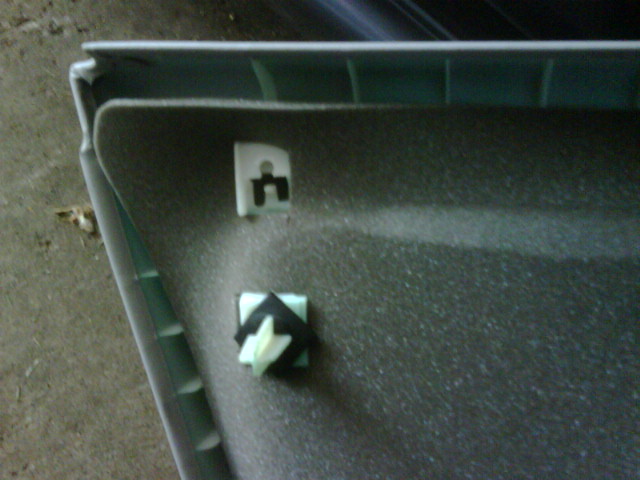

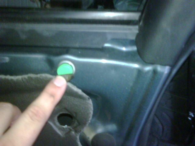

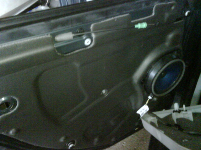

PASSENGER SIDE FRONT DOOR.
1. Remove round plastic cover that is in the door pull handle, this reveals a screw. remove this screw, there are 2 more in the bottom edge of the pannel, remove these. also i removed the red light cover just for a little extra spot to grab on to later on.
2. Start in the bottom right corner, use a flathead screwdriver and make enough room to get your fingers in there. now PULL...you will here a push plug releasing the pannel. work your way allong the bottom edge towards the front of the car.
this should release only the bottom edge of the pannel. it should flap around a little.
3. grab the bottom edge of the pannel that you just released in step 2, pull lightly out towards you and lift up. you will here a slight POP. you just pushed the clip release button ..if the pannel isnt already free..wiggle it a little and yer done.
this should only take 5-10 min.

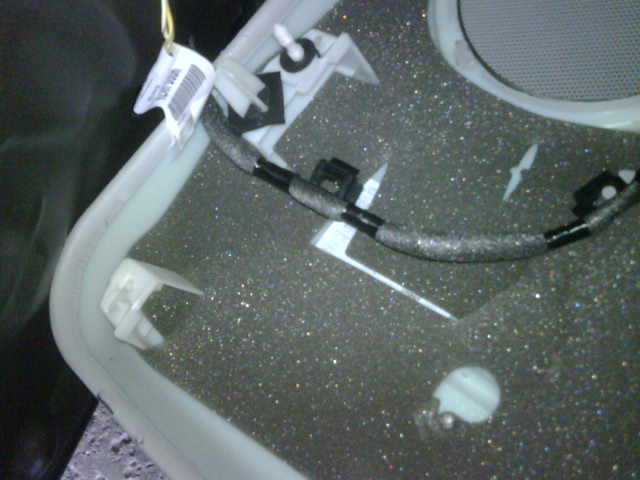

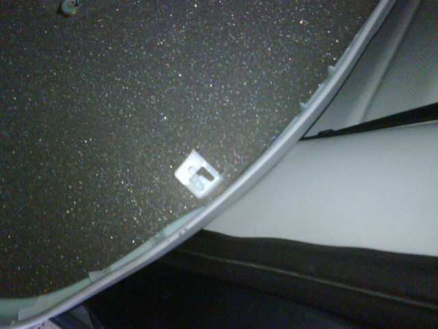

hey guys, i didnt realize i didnt put in the back door panels as well, so here it is.
the backs were much harder to remove, you have to pull, push and yank them like crazy, but make sure you dont snap anything. lol good luck!!
