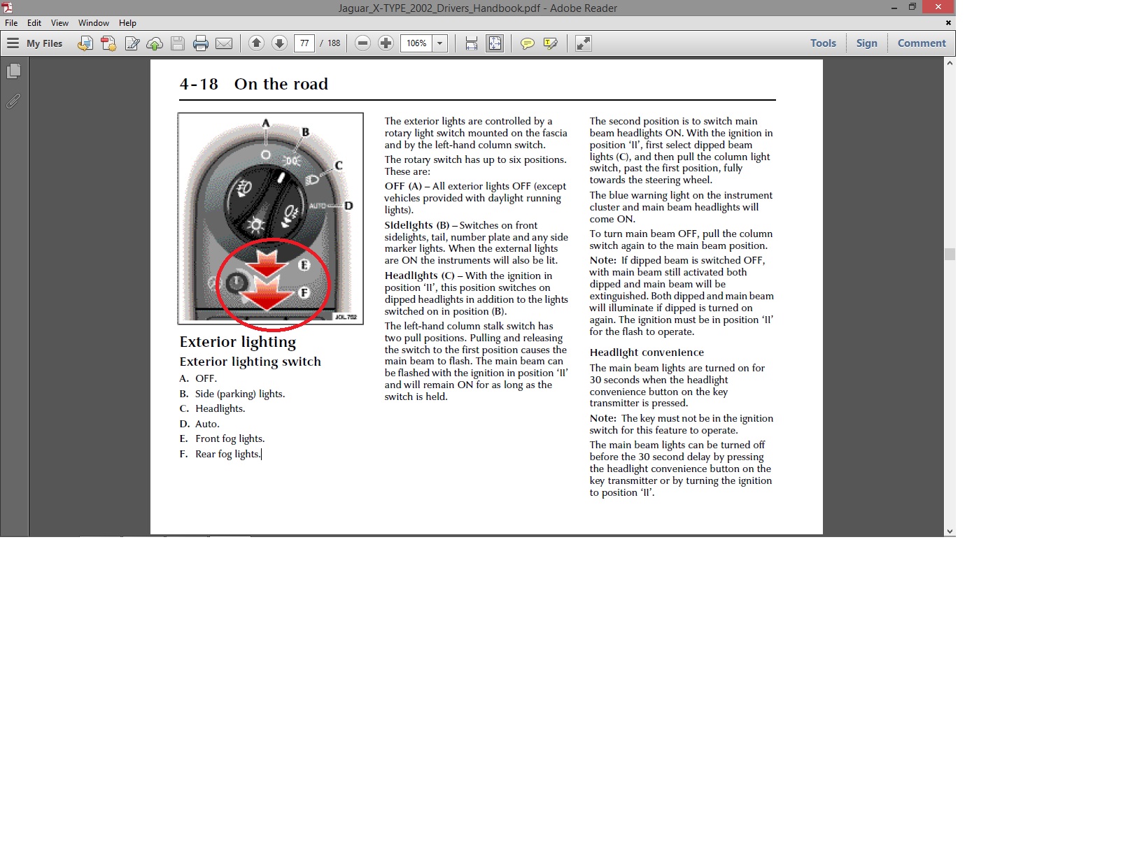

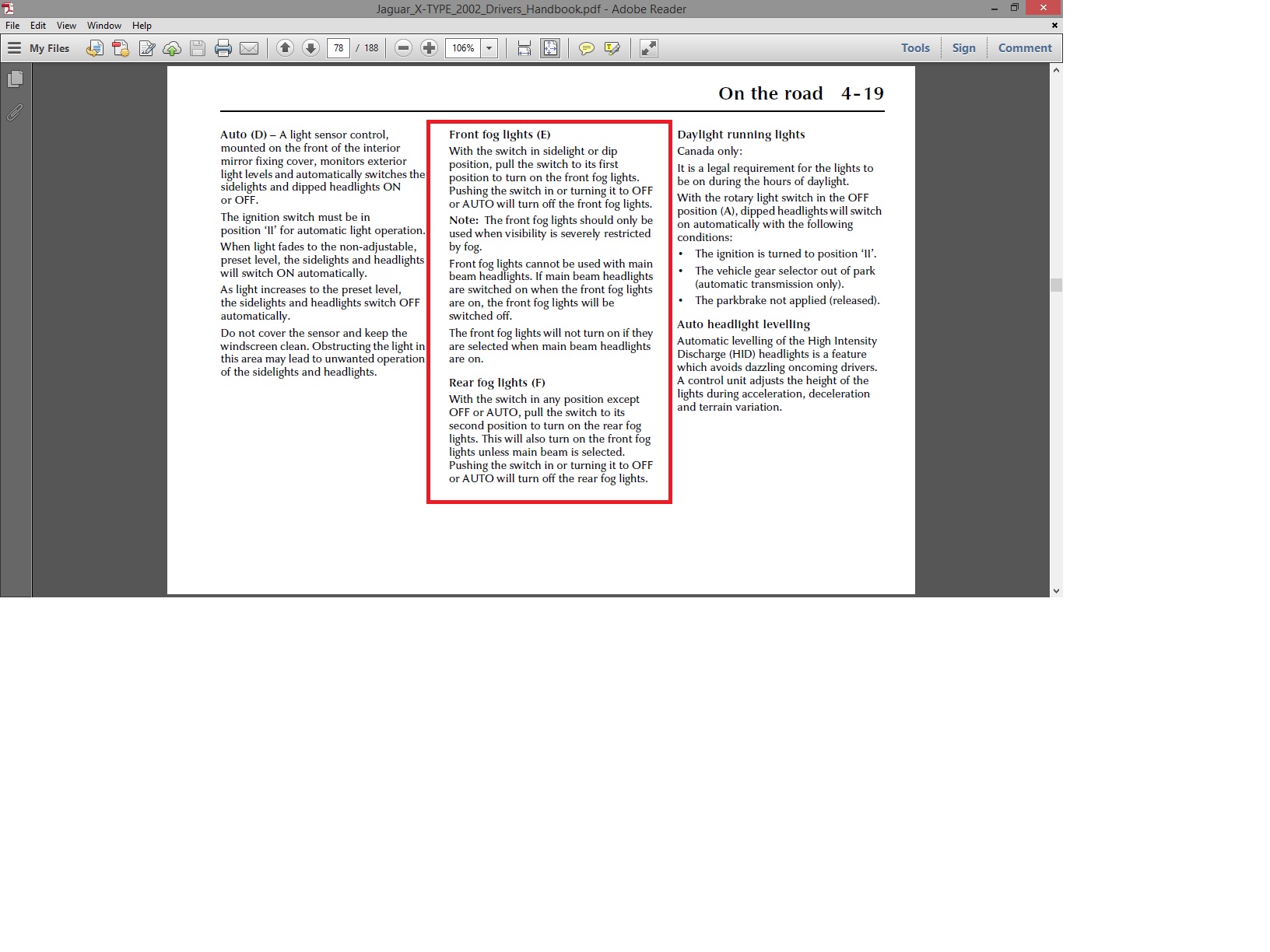

driving/fog lights?-fog01.jpg
driving/fog lights?-fog02.jpg
As shown here.... No worries (remember fog light go out when HIGH beams are activated.)
