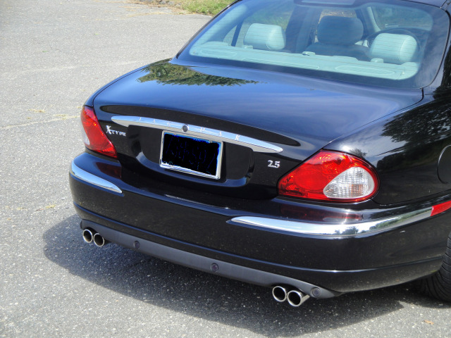

my 02 ive only had to change the brake pads
and wear and tear items
my wifes bmw 335ix is in the shop more times than ever i'm on the second fuel pump the transfer case is making noise ..we will be selling it
