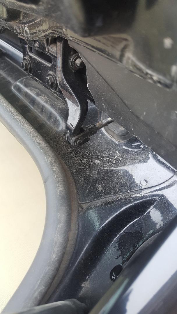

My Estate rear window air struts are bad. This winter, in the cold weather, the tailgate no longer stays up on its own. I've been using a stick to hold the rear liftgate up. A few days ago, in heavy winds, the lift gate blew up further, the stick fell out and it fell very quickly onto my head. Ouch! Gave me a huge knot on the top of my head. (Plus a lot of jumping around, numerous profanities, along with birds and stars flying around my peripheral vision.
I've searched the forum but have not been able to find a description of the best way to lower the rear of the headliner in order to replace the 2 window struts. (Dell Gailey to the rescue?)
I did find this searching the web, they they don't explain how to replace the window struts: https://www.jaguarforum.com/showthread.php?t=55320
Has anyone recently purchased a set of 4 of these struts? If yes, confirmation of the current P/Ns would be good. I'll purchase 8 of them to replace in both my Estates when I find the best price.

Turns out the information I posted above is only for the tailgate struts. The window struts are different and it took some time to find a P/N
JAGUAR PART NUMBER: C2S23550, C2S37601
https://parts.jaguarpalmbeach.com/a/...E/4735650.html
Plus this link showed on on internet search after I found the P/Ns and searched under the P/N.
https://www.jaguarforums.com/forum/x...s-help-215442/

Here is a link that explains where to find the headliner information. https://www.jaguarforums.com/forum/x...pports-131888/
