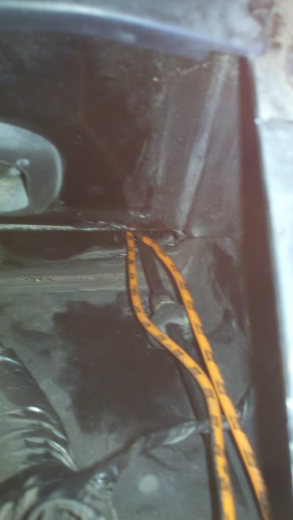

So here is the connector to the driver's side fan that you are going to have to cut to wire in the switch. Cut the connector and solder on two long pieces of wire (approx 8 ft will make it easier to feed, but less will do.) When you cut the connector make sure that you leave enough wire to strip and connect the connector back to the stock system when you can find the controller.

Now run the wires up to the battery and cut one of the pieces of wire (remember red is positive and green is the ground) and connect it to the positive terminal of the battery. Take the cut piece of wire which shouldn't be connected to anything anymore and connect it to the negative terminal of the battery. Now you should only be dealing with the wires from the negative terminal and the ground of the fans.
Will get a pic if the explanation didn't work
Take the only two wires which remain (stated above) and run them along the driver side of the car and under the strut brace. I ran my wires through where the hood release goes through the firewall. There should be a small rubber plug that you can pull out of the firewall with needle nose pliers and then push your wire through this hole.

Here is where it is nice to have long wires because the longer the wire is, the easier it will be to find under the dash. Once you find both of the wires, you can pull them through and tap them together to test the system. If you tap them together you should hear the fan turn on.

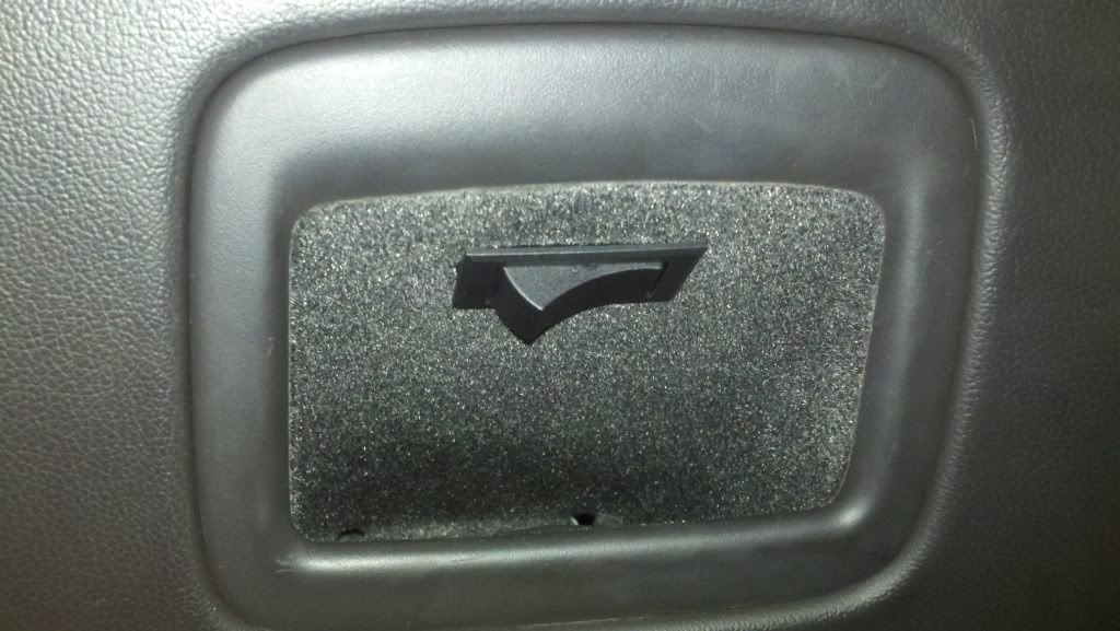

Now that you have both of your wires under your dash you can wire in your switch. I found a small hole in the little cubby hole under the light switches on the right of the steering wheel. Mine was just a hole, but there might have been a light there once. Anyways, I used a marine switch which I got from my hardware store for about $7. It will fit perfectly if you buy the right one. For example, mine was similar to this Switch, Rocker - Marine Switches - Switches - Electrical : Grainger Industrial Supply.
Then you just wire in your switch to both of the wires and your switch should just snap right into the hole in the cubby hole. I used a little duct tape (I know, but it was on the back of the switch) to help it stay in there perfectly. It looks pretty good actually.
