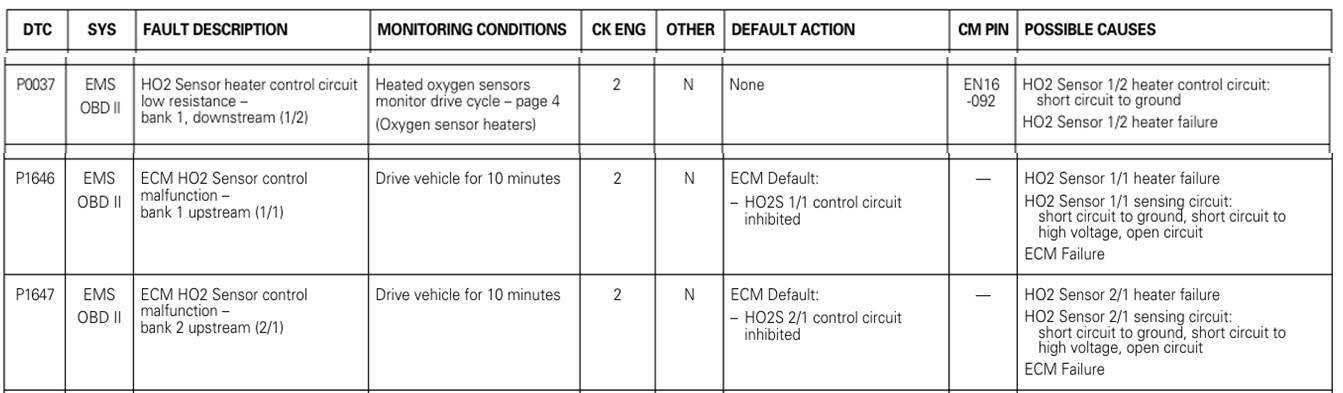

The common possible cause for those 3 codes per the Powertrain DTC Summary for OBD codes is a short circuit to ground in the heating or sensing circuit of the oxygen sensors. As others stated above these codes can stand for something else that makes the sensor readings suspicious to the ECM. Likely this is another clue and not the solution.
