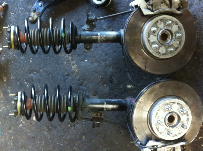

Hi there, thanks for you answer, now I have looked at the front struts I can see that they are interchangeable as you said, but can you help again please, is the stud that holds the brake hose retaining clip to the front strut, removable or pressed into the strut bracket, I hope that makes sense to you, Cheers, Chris.

Chris: The front struts have two metal brackets: one for the brake hose clip, the other for the top of the sway bar linkage. Both the brake hose clip and sway bar linkage are relatively easy to removed and reattach using hand tools.
The front bracket of the strut holds the brake hose clip, and the rear bracket is where the sway bar linkage attaches. The front & rear brackets are identical, which makes the left and right struts conveniently interchangeable.
Hope this helps.

Hi there, thanks for your reply, it's tremendously helpful as I have got to change the struts on Saturday , and I was really worried about it after looking at the old strut with the car jacked up , and thinking that the brake hose clip mounting to the strut bolt , was pressed in, thanks again for your help,Chris.
