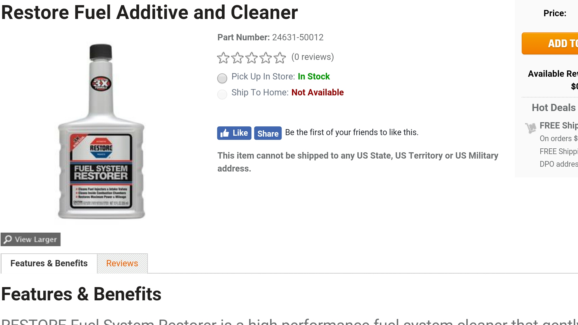

A couple of weeks later, I read about this in another forum post. I've never been a fan of additives (too skeptical) & my exhaustive research has shown actual before and after valve, piston head photos of pretty much all the top additive, i.e. Seaform, gumout, plain water intake treatment (scary), Lucas, STC, Techron, etc. to me are less than impressive.
That being said, I gave this one a shot, and thus is certainly subjective and not backed by any science, but all I can say is my car started acting alot younger. Better jump off the start, better pick up on on-ramps, jumps out to pass better.
