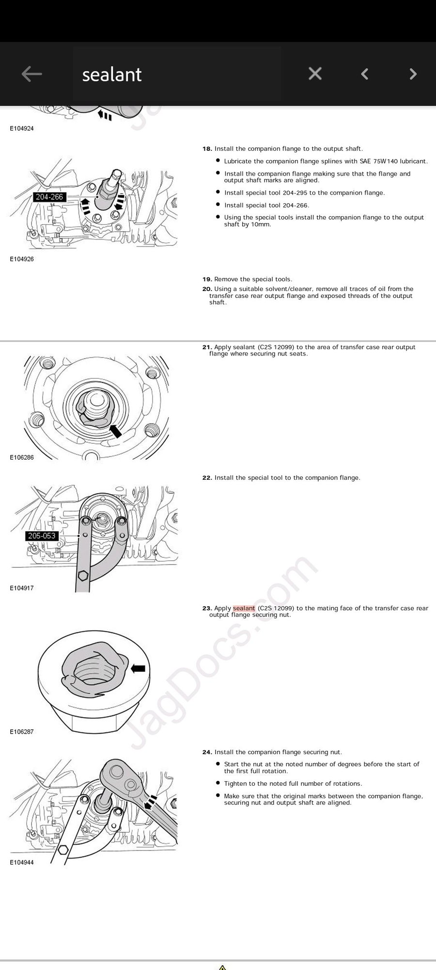

Hello, i have a 2003 AWD 2.5 petrol, should there be a gasket or something in a marked place in a picture? Because previous owner was generous on silicone and there was silicone in that place. Also there was/hermetics silicone/hermetic where flange nut is located but that's probably because oil was leaking so I'm going to replace the seal between the flange.
Should there be a gasket?

so apparently there should be sealant
