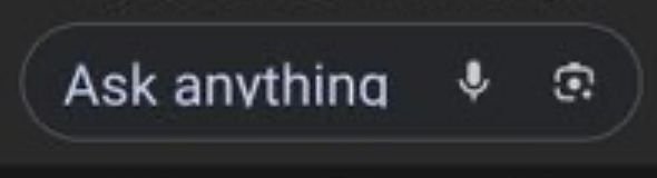

"Idk why with all the options the original owner bypassed that option"
well....
the googles knows everything 😂
