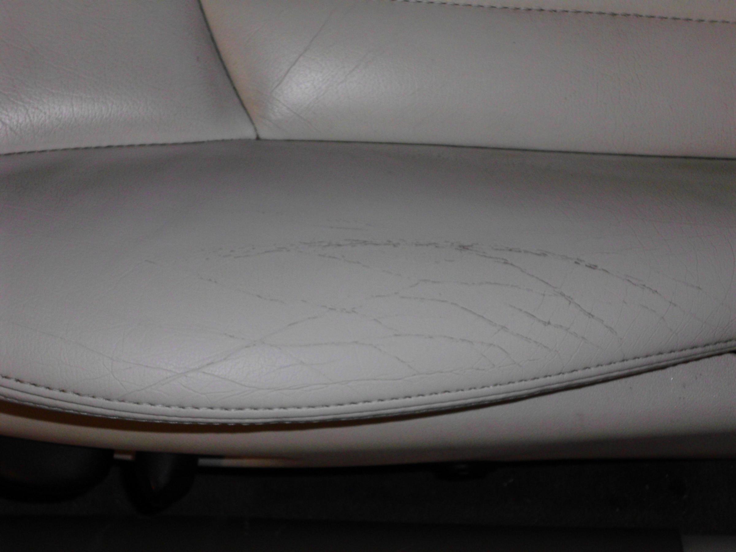

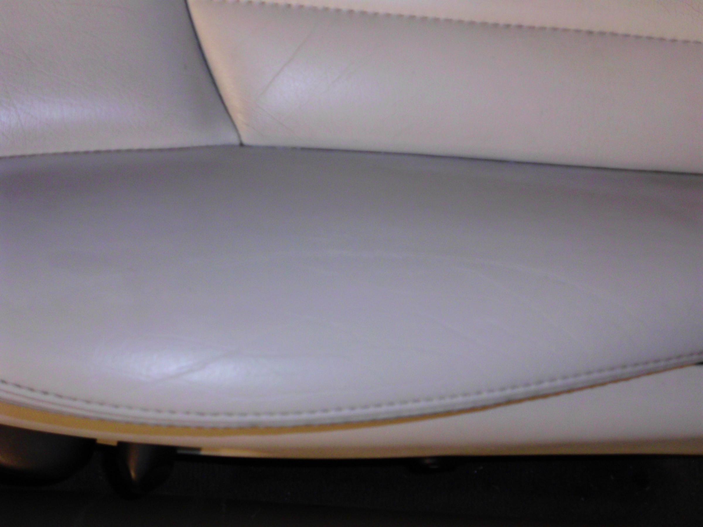

I have used the Gliptone dye on smaller sections of my seats with decent results. (See below). I have never done an entire seat, but I will share what has worked for me so far.

After the dye has absorbed for a few mins (2-3), take a damp soft cloth and GENTLY wipe. If you get areas that are lighter, let wiped areas completely dry and reapply a thin coat of dye to the lighter area, blending it with the area around it, let dry a few mins, then wipe again. It may take 2-4 coats to get an even color. I was lucky? and I got my repair areas to blend after 2 coats of dye.
