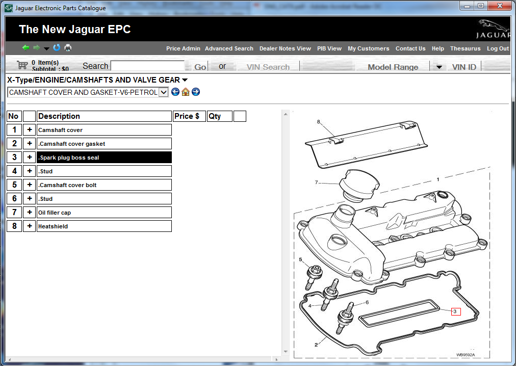

Oil in the plug wells is usually caused by gasket #3 failing or being misaligned. If you're going to replace gasket #3, also replace gasket #2. Short term (or cheap out) you can soak up the oil and see how long it takes to fill back up.

So, as mentioned above, oil everywhere in the plugs. (Ergh.) He replaced the gaskets, the plugs, two coils, a pcv valve of some kind, something about a tube for water and an o-ring he had to go to Jaguar for, and also discovered my water pump was leaking, so he replaced that as well. Do I feel like the world's worst car owner? (Spoiler alert: I do.)
