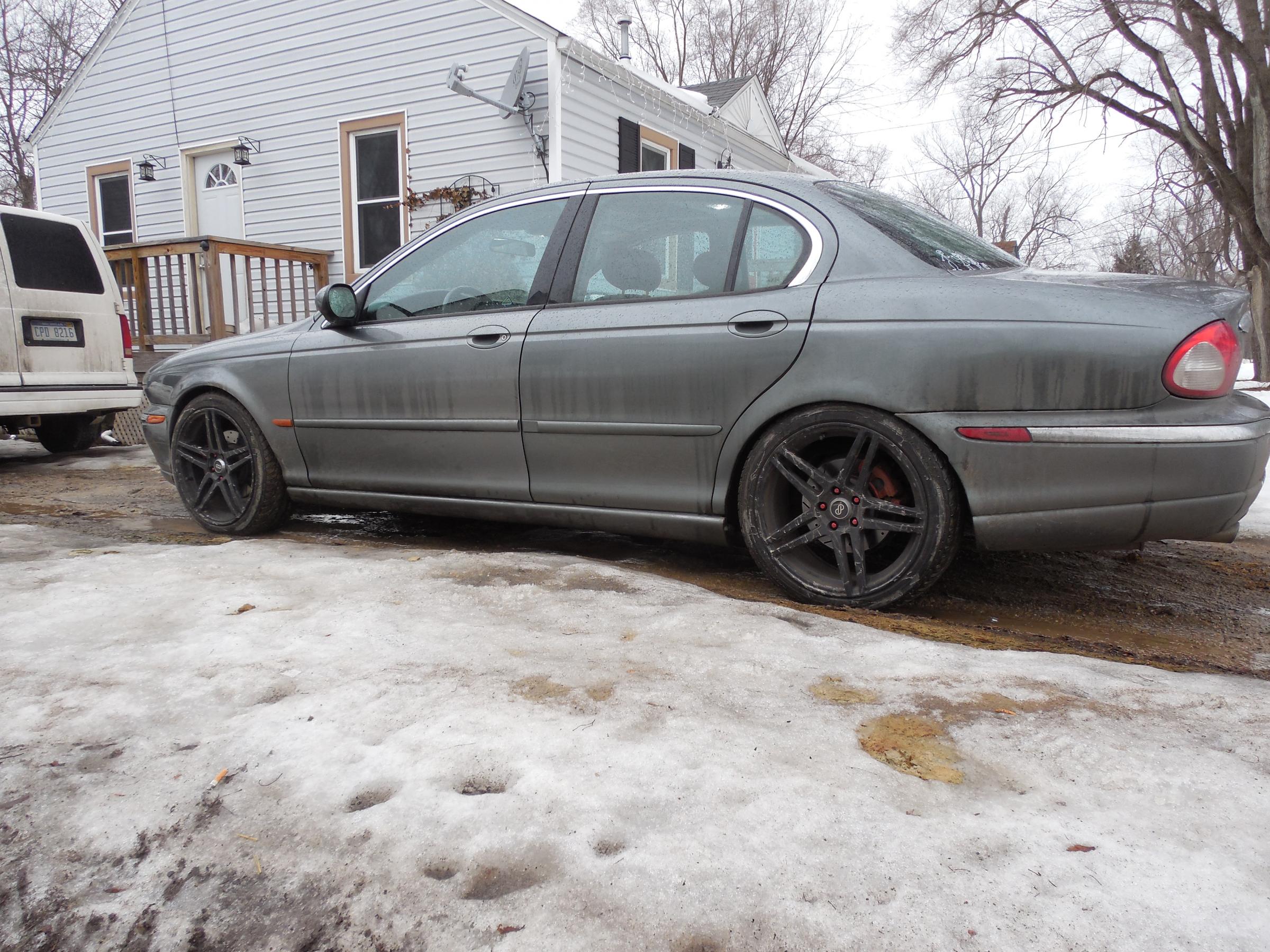

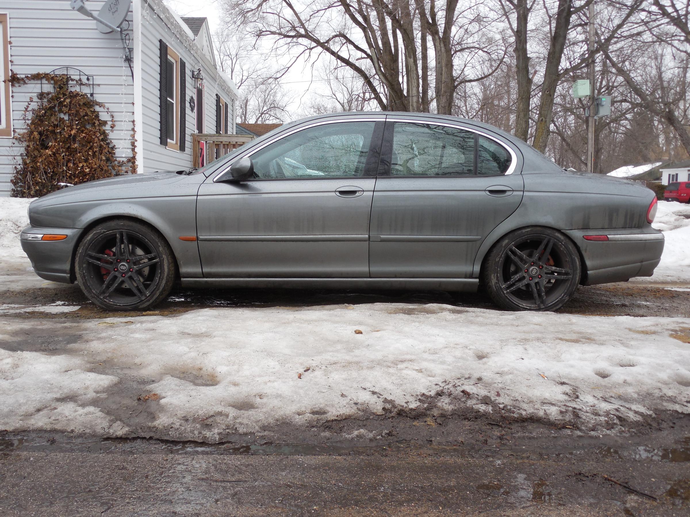

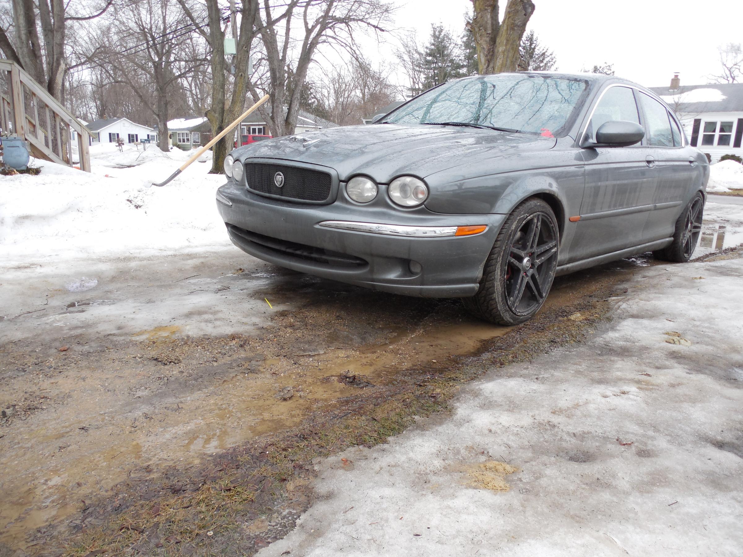

All smiles over here. Trunk is full of the old struts, shocks and springs and that's where she sits. No rub in the rear at all but I have a lower offset wheel so even with the 225/40 I'm getting a little rub on the front inner fender wells. They'll disappear this weekend.

Oh wow, sweet ride. Looks like a 2009 x-type. Like that color with the wheels. Back looks really low, any rubbing or anything with those wheels? The front looks like it has some clearance. I was worried the front might rub my tires. I have the 17's with the 45 series. It looks like it's going to be a close fit but I think they'll work since they are just the stock tires.

Thank you sir. No rub in the rear at all and that's not where it will sit. I still have the old equipment in the trunk which weighs probably 50lbs so as soon as that comes out it'll raise up slightly. The front is actually relevant to the rears in height it's just the design of the rear arch that makes it seem lower. The front only rubs at the rear of the tire on the inner liner. Easy fix. I'm going to do some major fender mods, like Justink, and step up to a 235/40/18 or maybe even a 245/35/18 next time to get a little more tire under me. The roads in Michigan are the worst I've ever seen.

Oh yea if you have a lot of weight in your trunk that makes sense. I was like dang, they don't give you much leeway for hitting bumps in the back.

That is a sexy looking car. When you first posted I thought oh brother, some guy is getting lowering springs now on his old stock x-type. But that is actually a nice looking car. Definitely looks a lot more like a sporty Jaguar with the lower stance... Like a cat on the prowl!

Haha. As soon as I put the wheels on it seemed like it accentuated the wheel gap for some reason. Stock wheels weren't so bad but I think it was the lower profile that created the illusion. Either way, I had to get rid of it. The new stance and feel is what it needed!
