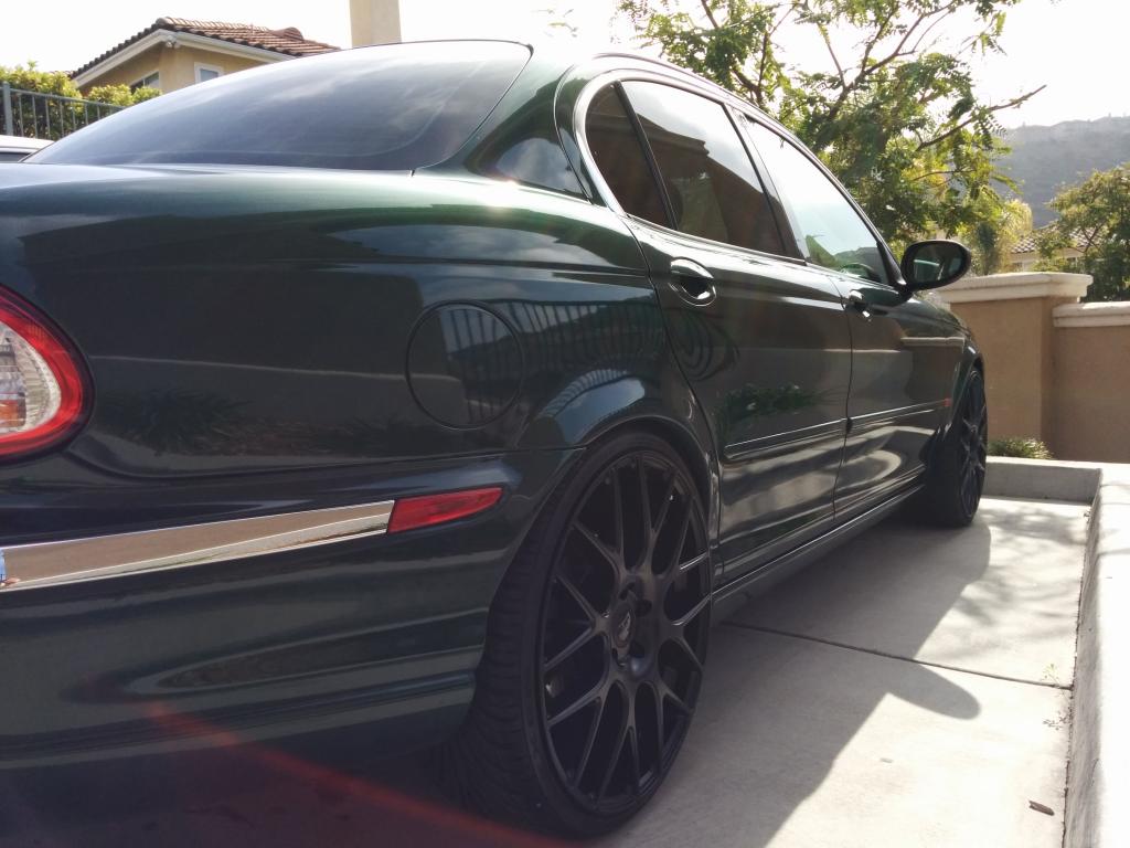

I am not getting any wheel rub on 20s with 215s and I had 10 old desktops loading down my back today and the rim was riding right next to the fender, this picture is just where it rides with just my woofers in the trunk
I've checked your car out a few times man I love that style wheel and how the 20 fills it out but there's no way I could run that size tire in Michigan. Looks good dude! Makes me want to clean mine up haha
LOL, ya man thanks I gotta watch out for potholes like a mother out here too...I have lifetime alignment so almost everytime I hit a big pothole I am off to get it realigned.
