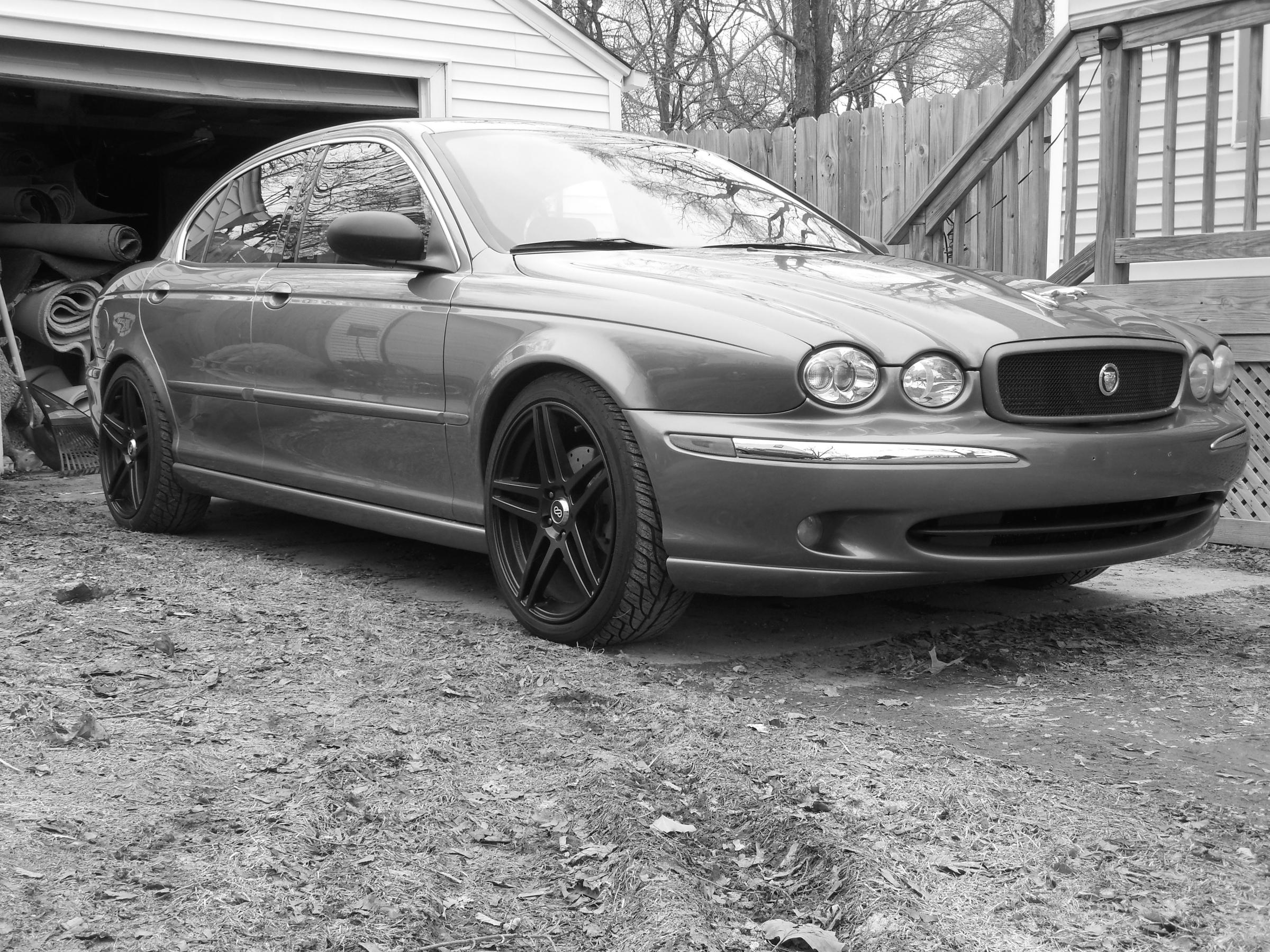

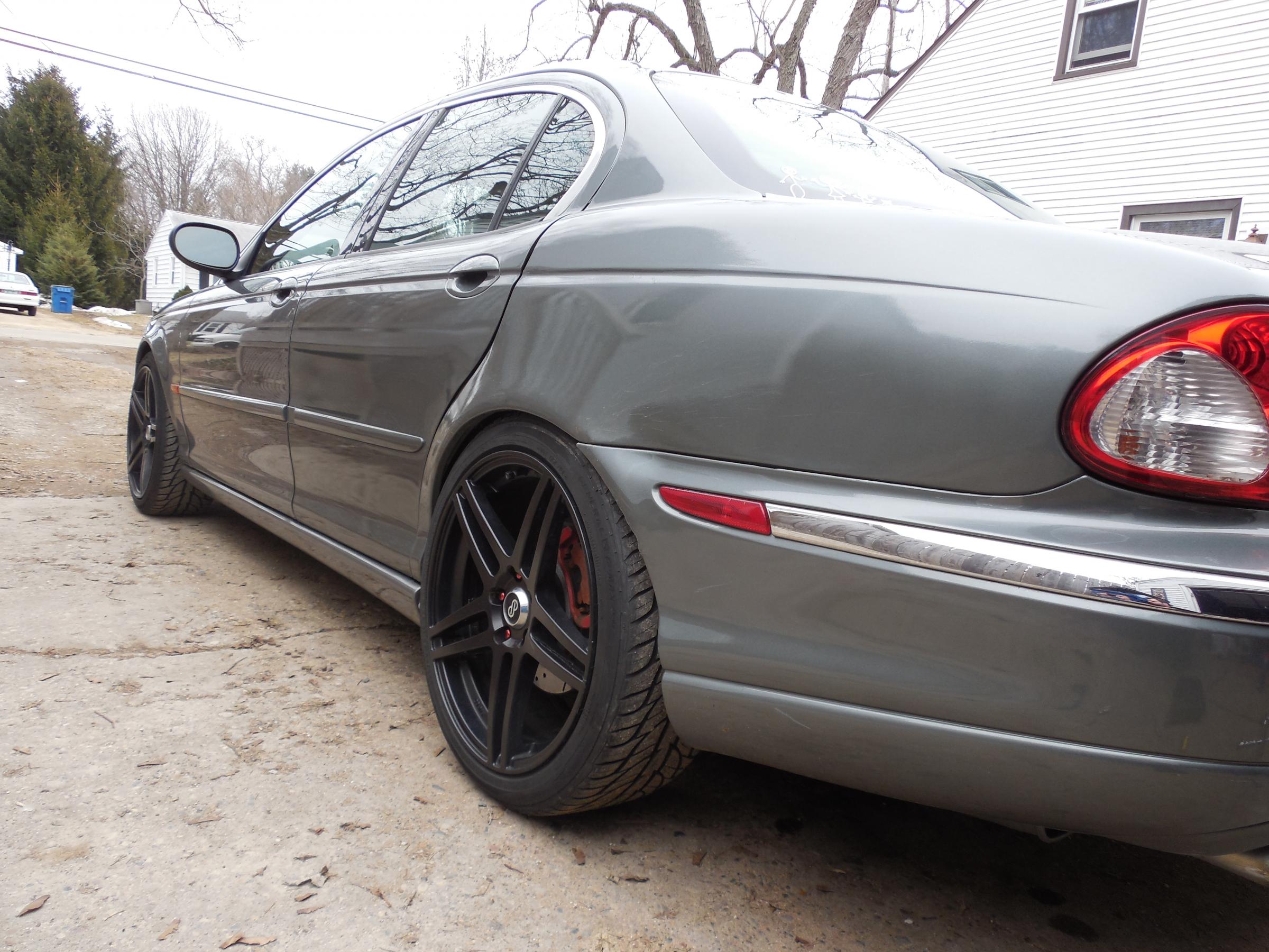

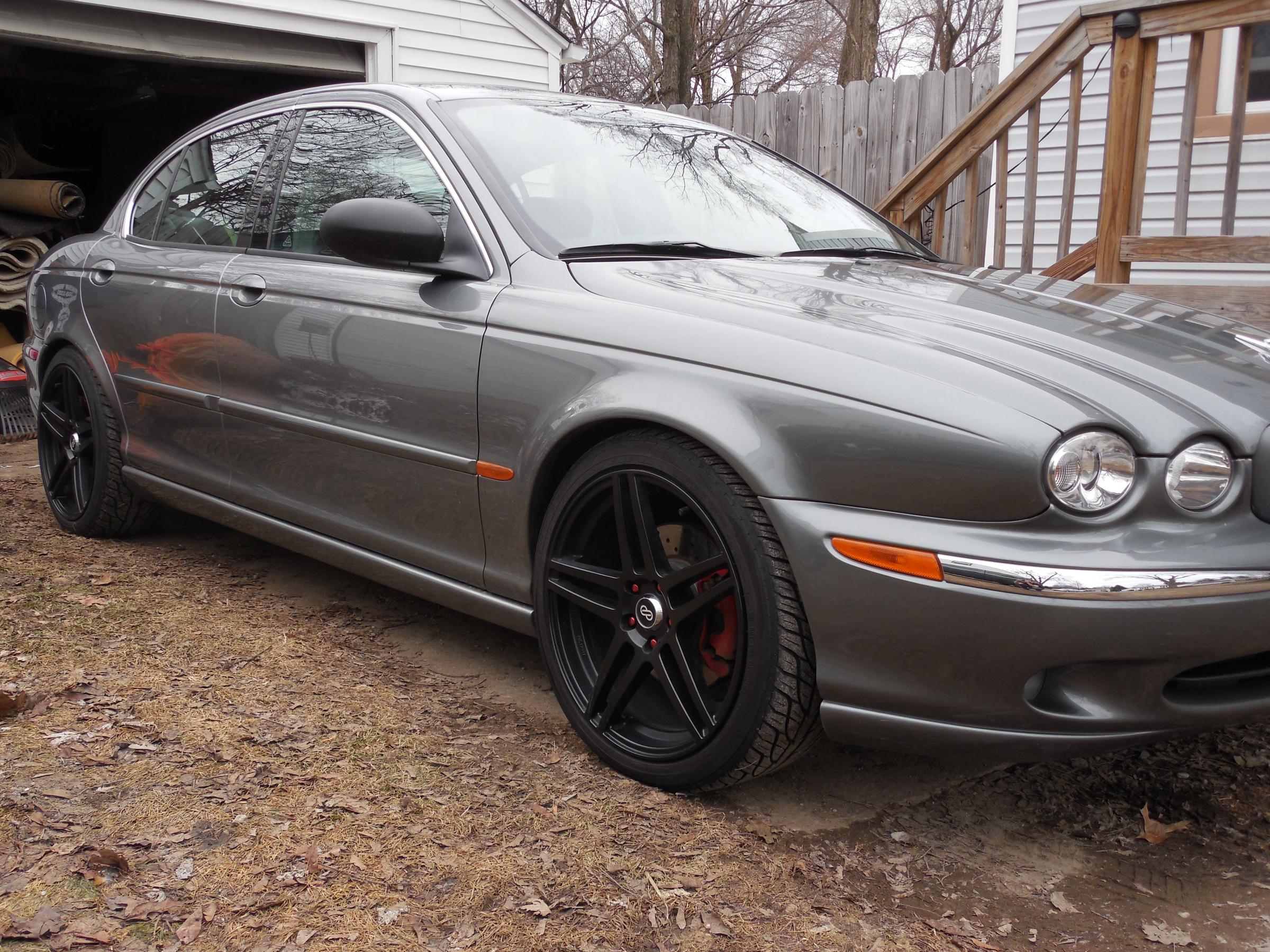

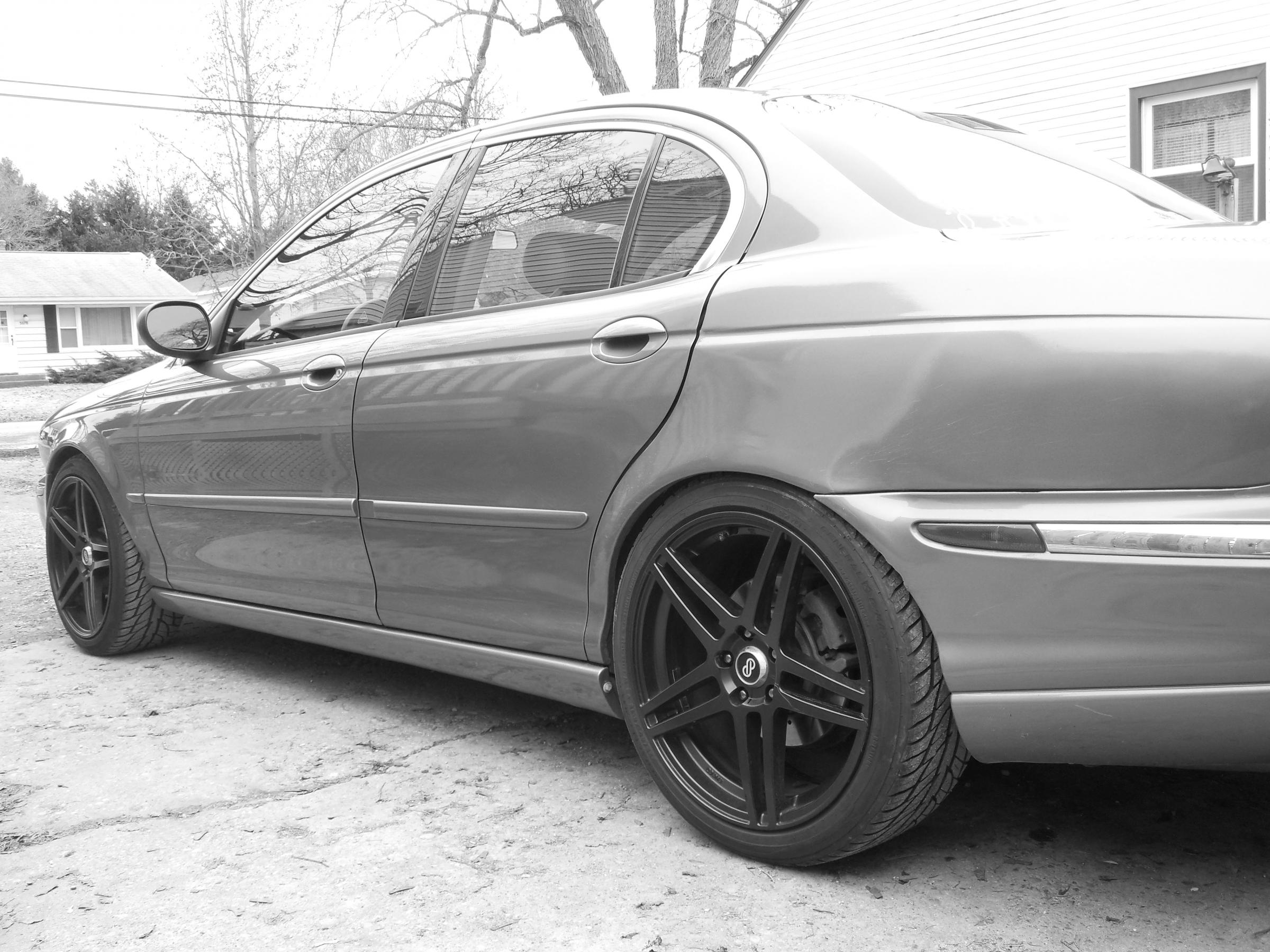

Cleaned up and springs settled

Old Mar 31, 2014 | 08:09 PM
  #90
Justink201's Avatar
Posts: 604
Likes: 92
From: tampa bay FL
Looks good.
