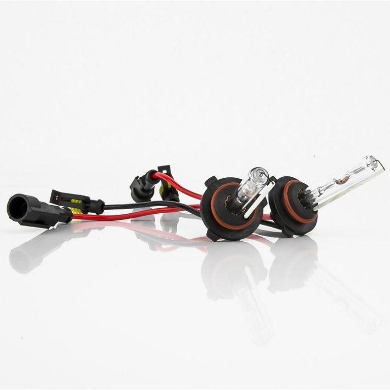

Follow up question on the modifications. Did you cut the connectors off the HID bulbs to pass the wires thru the H1 bulb holder, then splice them back on? the connectors are quite large. (Pictured). Thanks

I did not have to remove the connectors, but you have to fit the larger connector through first, then squeeze the smaller one through second. You have to hollow out the adapter piece completely. This gives you just enough room. I used something like a 1/2" drill bit as I recall to hollow it out. I put the connector in a vice and then just drilled straight down through the connector. I then used a file bit like you would use on a pneumatic grinder to then open up the inside where I made my 2 drill holes. It doesn't take long to do. Just have a good RTV ready so you can feed the wires through, get the bulb close, squirt in a large amount of RTV and squish it all together and then fill the bottom of the connector, pushing it back towards the bulb some. Messy, but once you are done, it makes for a nice seal. I personally would be looking at the H11 bulbs as that is going to be easier and be more "plug and play".
