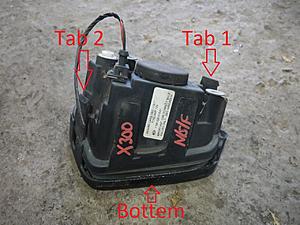

They come out from the front and don't try too hard on the taps as they are plastic . Run some soapy water in the lens assembly and coat the wiring metal with some bulb grease afterwards . If you use spray in will get on the inside of the lenses which will attract dirt . You can repaint the plastic trim piece but sand first for paint adherence . Burnt Red color ?
Attached Thumbnails fog lights-x300-fog-s-l1600-28-.jpg   fog lights-jaguar-x300-fog-s-l1600-29-.jpg
