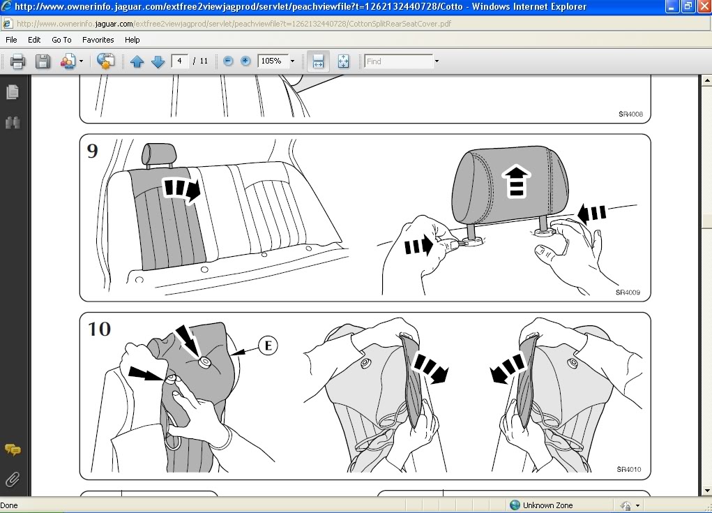

Found out there are 2 clips holding the headrest in place and one is easily to miss (needs a coin to depress it) as per Fig 9
Hopefully this is what he has missed
I'll email this pic to him but if its not this any ideas how to remove?

It was the "hidden" release clip that was the cause!

BuckMR2,
Many thanks for the screen shot of the second release tab.
I can't believe that I overlooked that thing!
