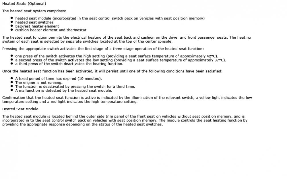

I found this info in the x-type service manual page 2458.
Both the driver and passenger side seats (if equipped) have elements in the back and bottom.
Hope this helps.

Thanks!
