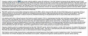

The most common fault for DSC is a dirty wheel speed sensor. You need to remove and clean the face of each of the 4 wheel sensors. Also you should inspect the wires for damage. While the are out you need to examine the reluctor rings through the sensor mounting hole. If they are heavily corroded spray some WD-40 or solvent on them.
I think it is the left rear sensor that provides the input for the speedometer so you need to make sure it is in good condition. I would check the circuit continuity for all 4 sensors.
