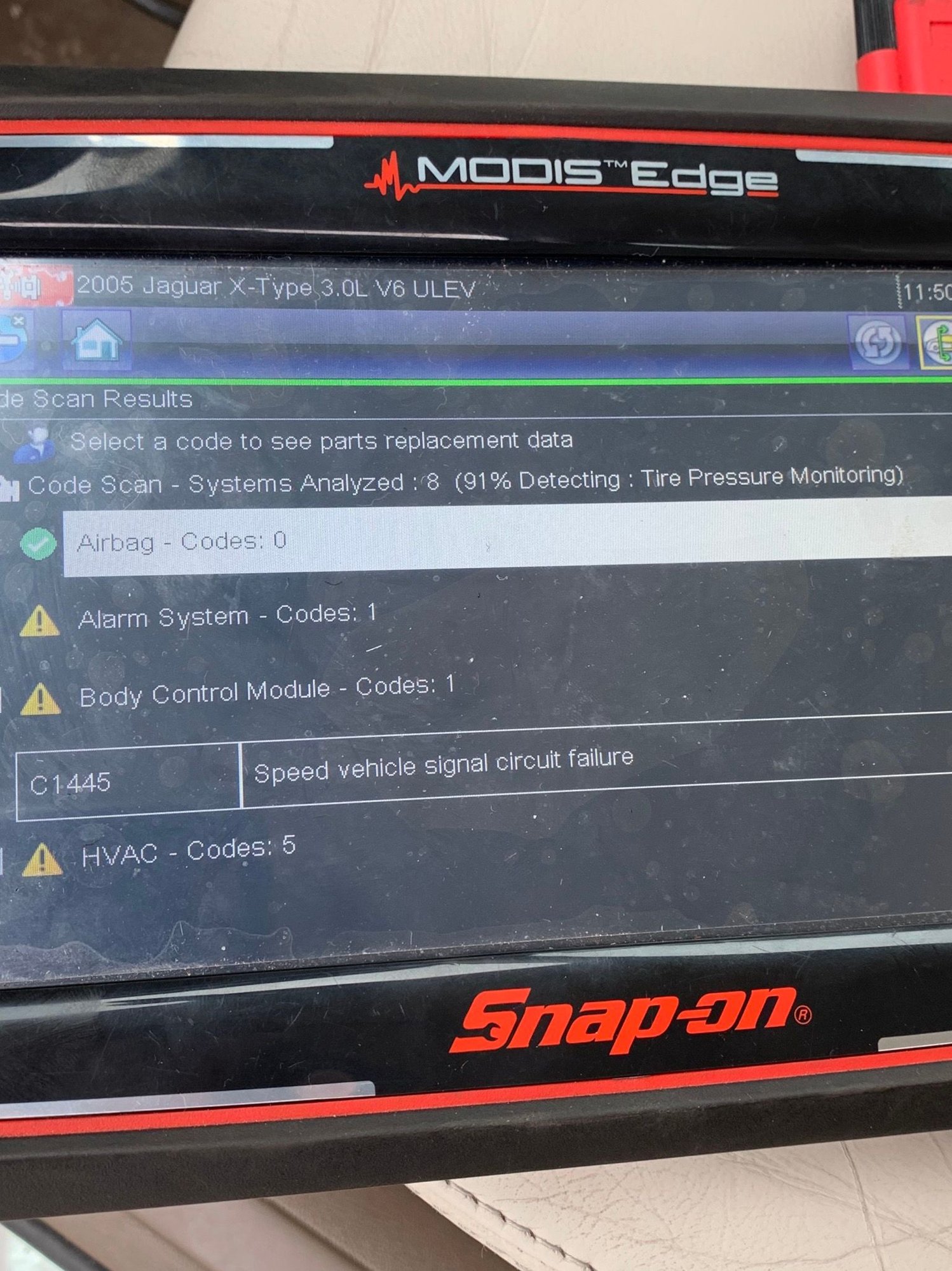

Default Oh no! Many codes!
I was hoping to find one problem with maybe a wheel speed sensor. About a month ago, the DSC ABS SYTEM FAULT came on after a grueling drive in rush hour traffic. It turned off three days later. Now, a month later, it’s on for good. I took it to a mechanic I know and he pulled the codes attached. Hopefully they are old, or just irrelevant uncleared codes. Other than this ugly situation, car runs great!

The C1279 coud be your problem as it is for the ywa sensor which will cause the DSC message. Here is a thread that explains about it: https://www.jaguarforums.com/forum/x...t-i930-163004/

Thanks for the reply. I read that I should try to first clean the abs sensors etc before ordering the part for the yaw repair.

I had the "DSC Not Available" as well as various CANBUS communication failure codes. Per one of the codes, I replaced the right rear ABS sensor which knocked out some of them, but the Yaw Sensor code remained. The yaw sensor is underneath the shift lever and, if you have an automatic transmission, is easy to replace. Mine is a manual transmission and it was a gigantic PIA to change it out. The price of a new OEM yaw sensor is crazy (somewhere around $ 400) so I bought one on ebay from a salvage yard. for under $ 100. MAKE SURE the part number on the replacement yaw sensor is the same one that's in the car, that is critical! I didn't, and the first one I received wouldn't fit (connector was on opposite side than the original). Sent it back, found the right one, and the DSC code went away.

If you had a problem with one of the wheel speed sensors I would have to guess a code would have showed up for it. I didn't see any on the list. Yaw sensor would be the place to at least start. Contact a member on here, Dr. Dome, as he parts out X-Types and probably has some used ones for a reasonable price.
