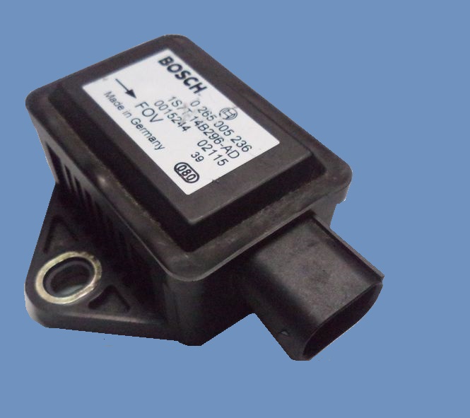

It is under the console, behind the J-gate...I'll let you know for sure after I check the service manual...I have to replace mine, since it has been gradually losing its mind (delaminating), and the replacement is en route.

To change it, pop off the right side console side cover (move the seat back, find the single screw that holds in in; the rest are just clips). The box in the pic is pretty close to actual size...it is located just below the J-gate.
Take out the electrical plug, unbolt the old one (2 x 8mm, I believe...may have been 10mm), reverse the procedure to reinstall.
Literally a ten-minute job, start to finish.
Mine was bad; apparently they can delaminate internally...rare, but it happens), Only symptom was an occasional "DTC unavailable" message and a ABS pulse through the brake pedal for no apparent reason when stopping. Not enough to light the TC or ABS lights, so it was a bear to track down!

No chance of fixing it...sealed up pretty tight. Correct, just the right hand cover, it will be right below the J-gate in the clear, even my fat hands fit in with room to spare. They are bolts on studs, so the bolts come off, the old one lifts out, and the replacement drops right on the studs.
Put the bolts on, replace the cover...done.
I looked at the ratchet, it was a 10mm, and I needed a short extension to get at the back bolt; a 10mm deep would do the job without an extension.
The picture above is close to actual size, by the way. PN is 1S7T-14B296-AD, it is specific to the X-type. The only cross ref is for the Mondeo, the Contour and Fusions use a different type. There are a few on eBay in the $50 neighborhood.
