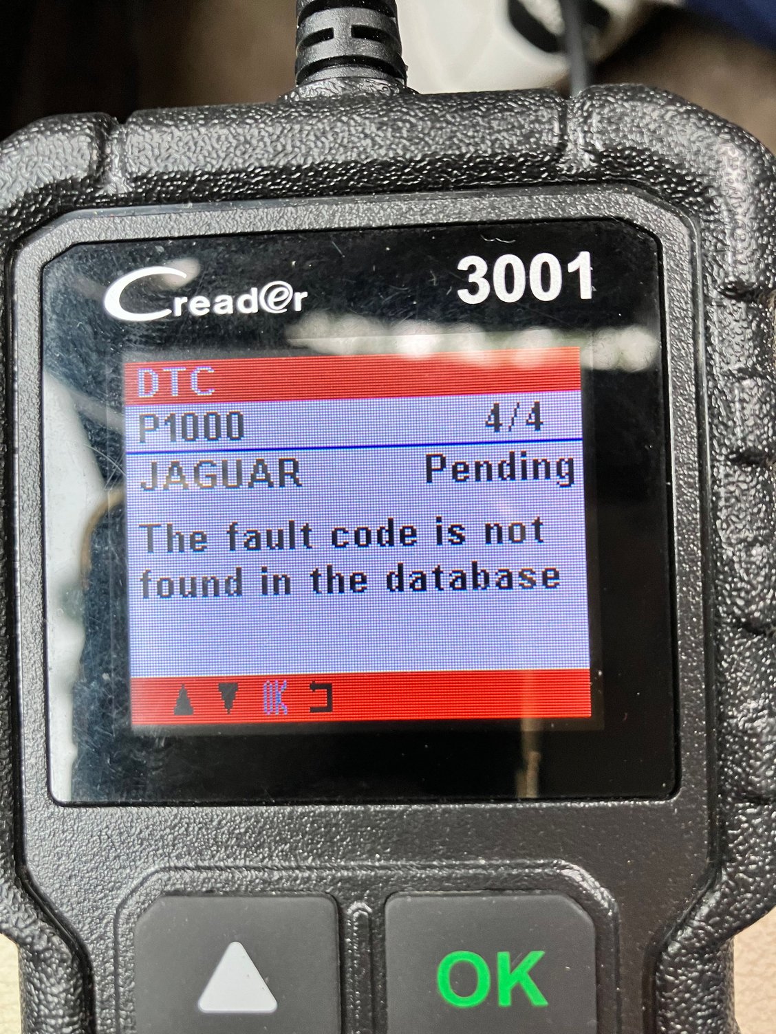

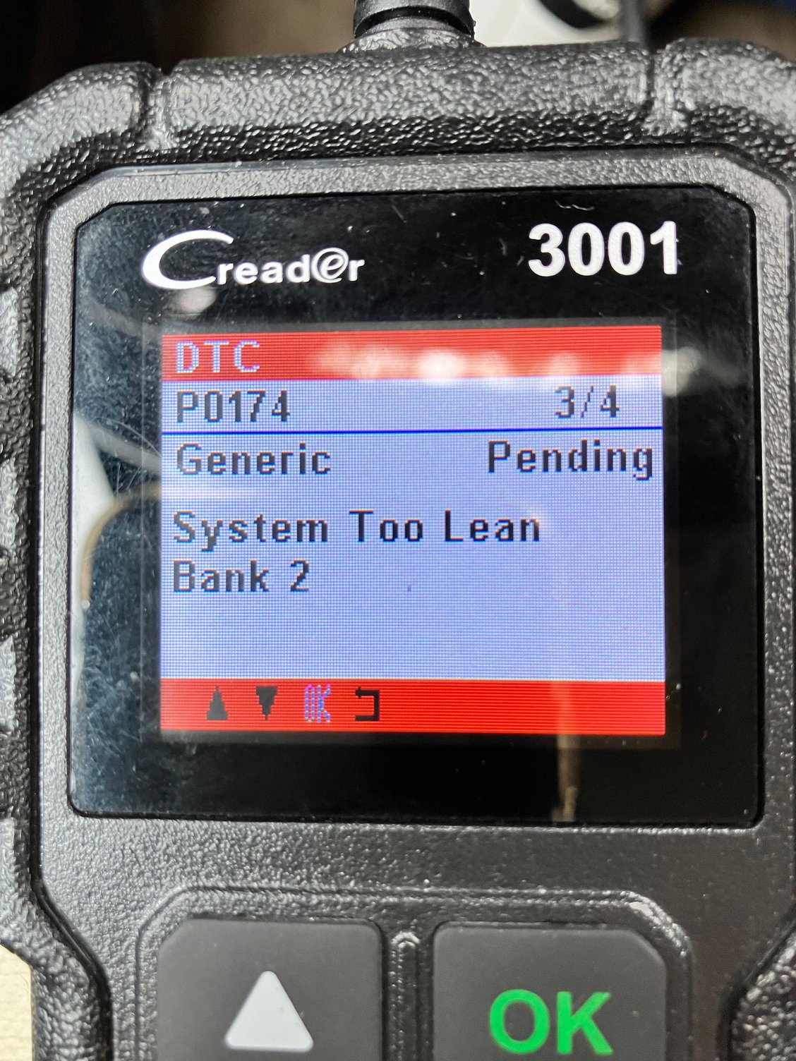

Old Jun 3, 2023 | 01:42 PM
NYCJAG2006's Avatar
Joined: Oct 2018
Posts: 272
Likes: 11
From: NYC

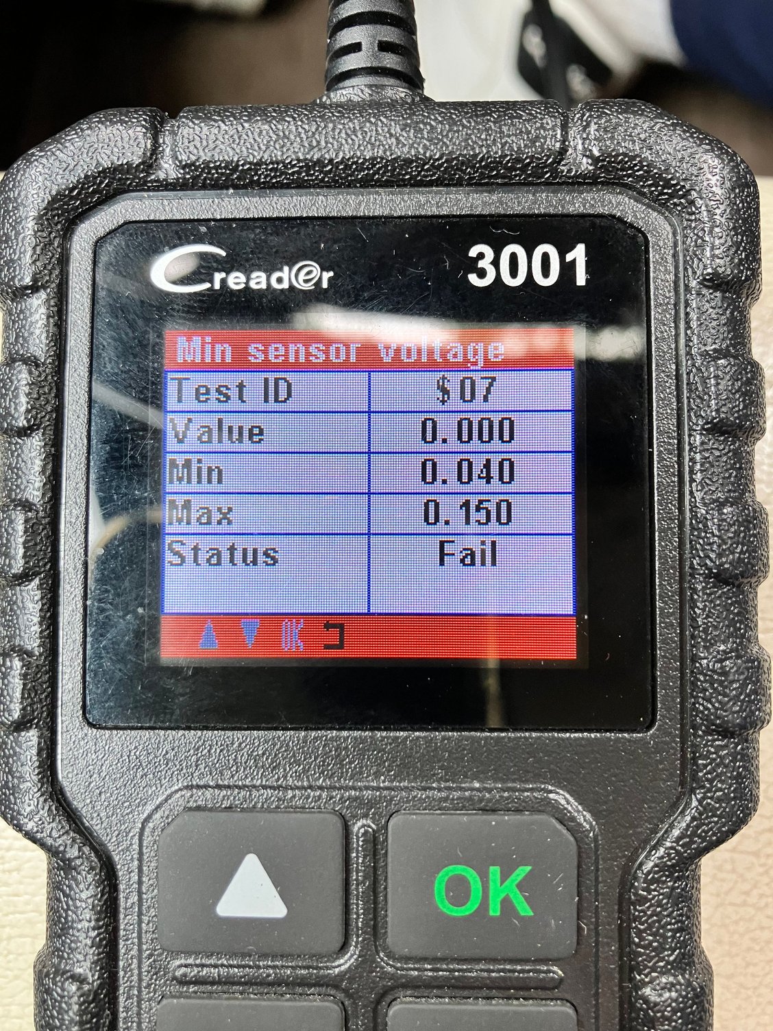

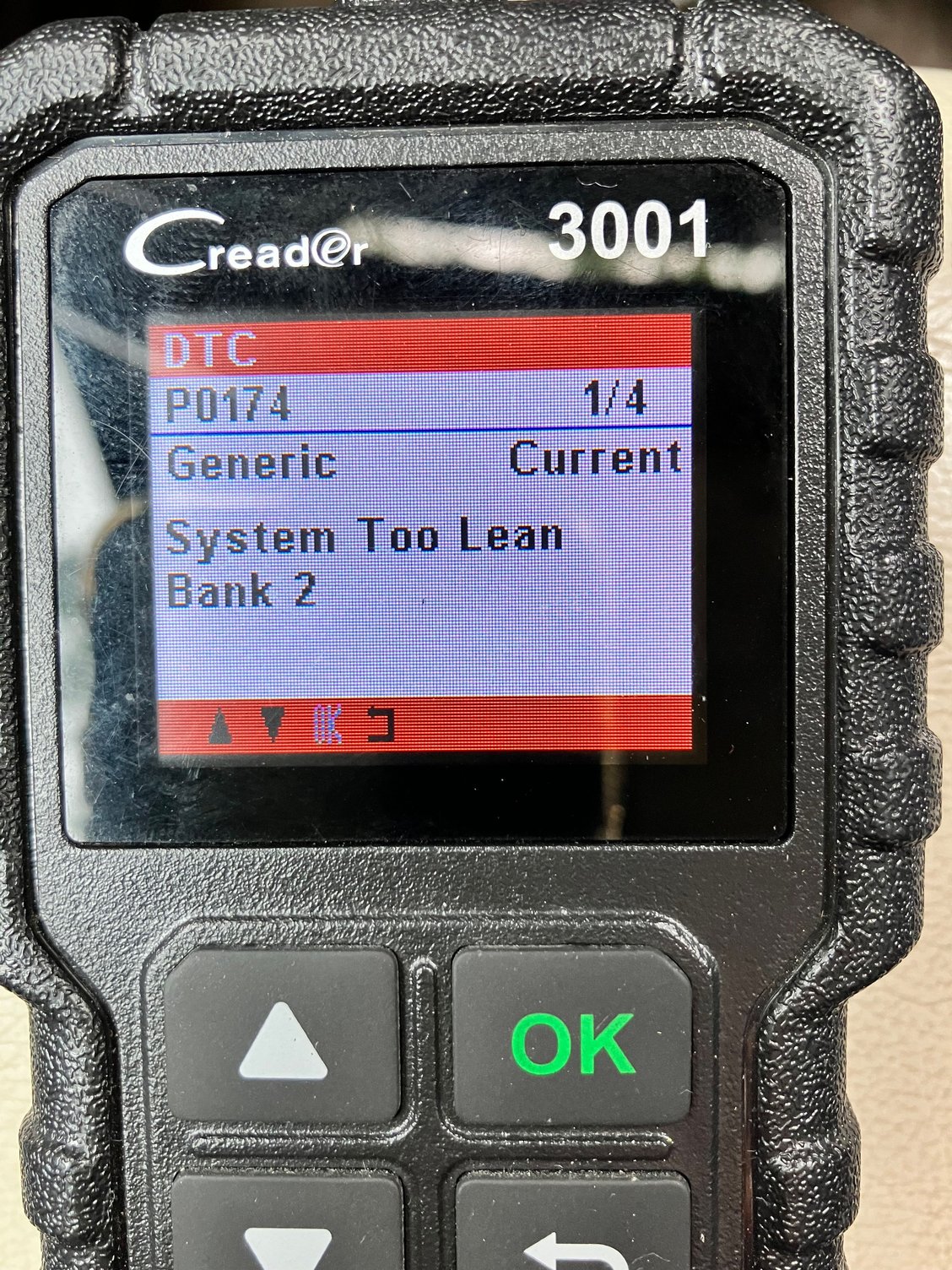

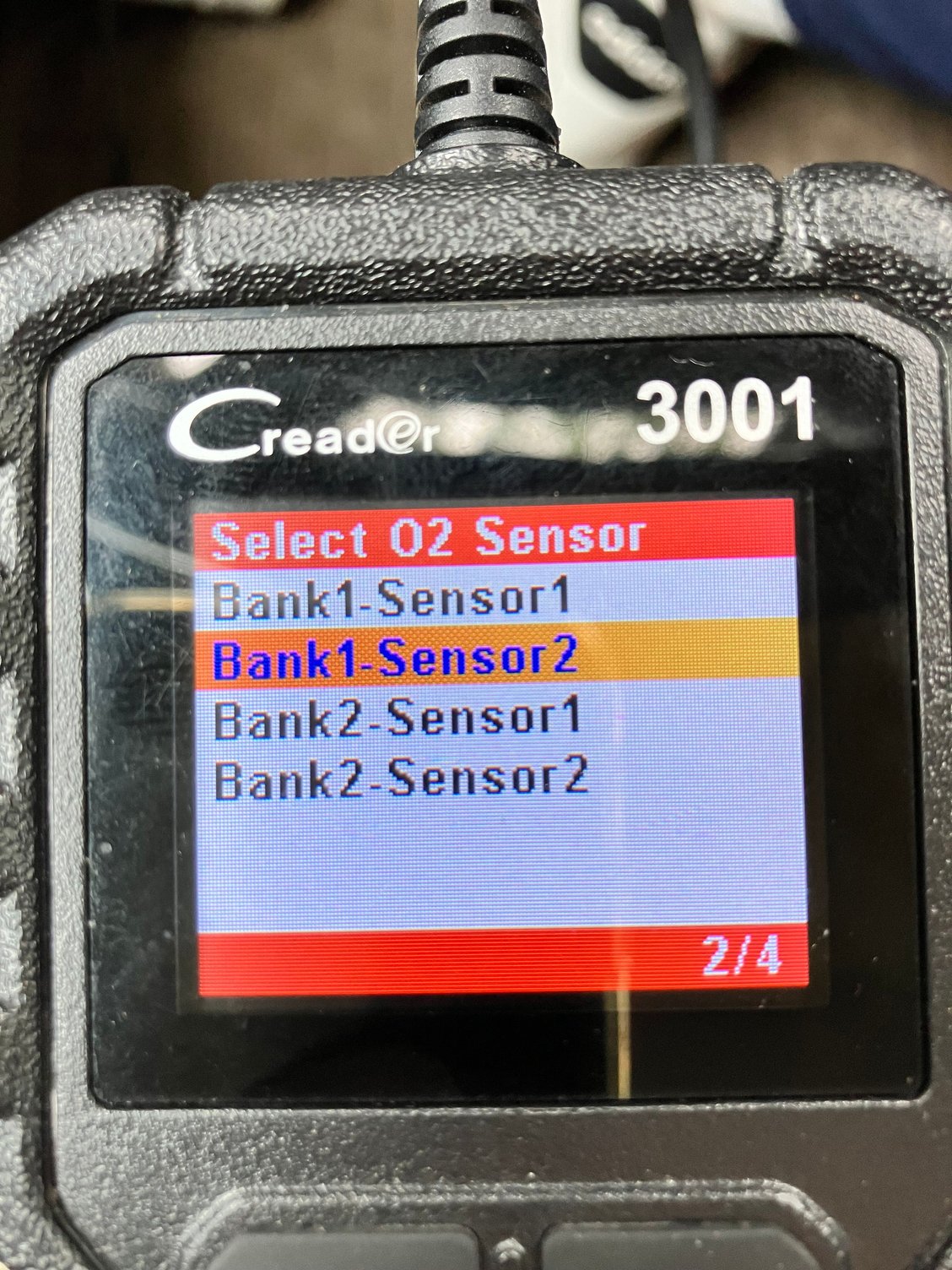

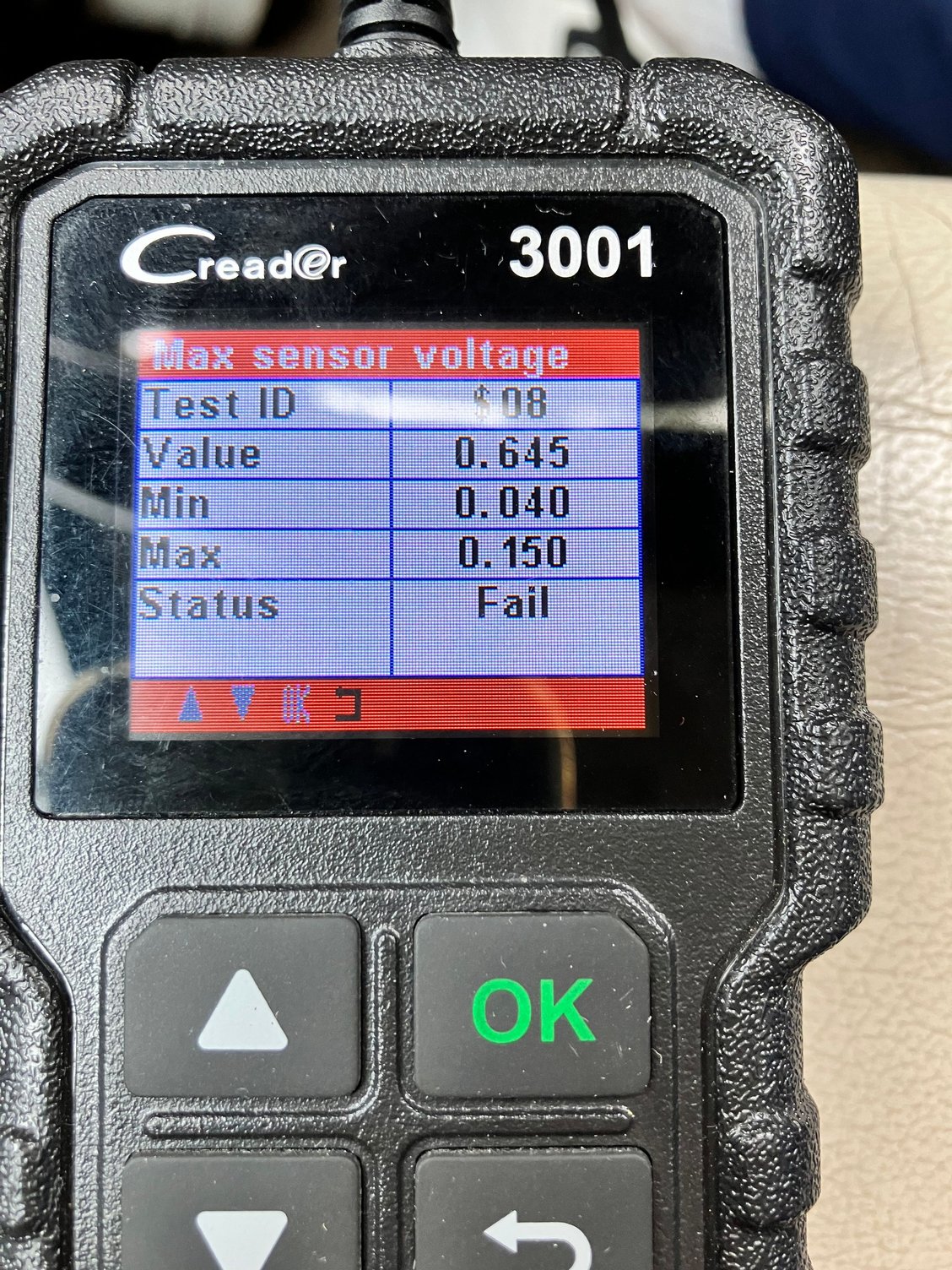

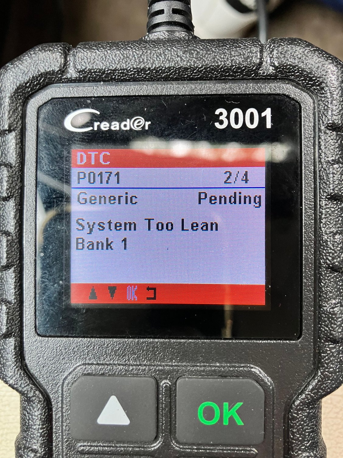

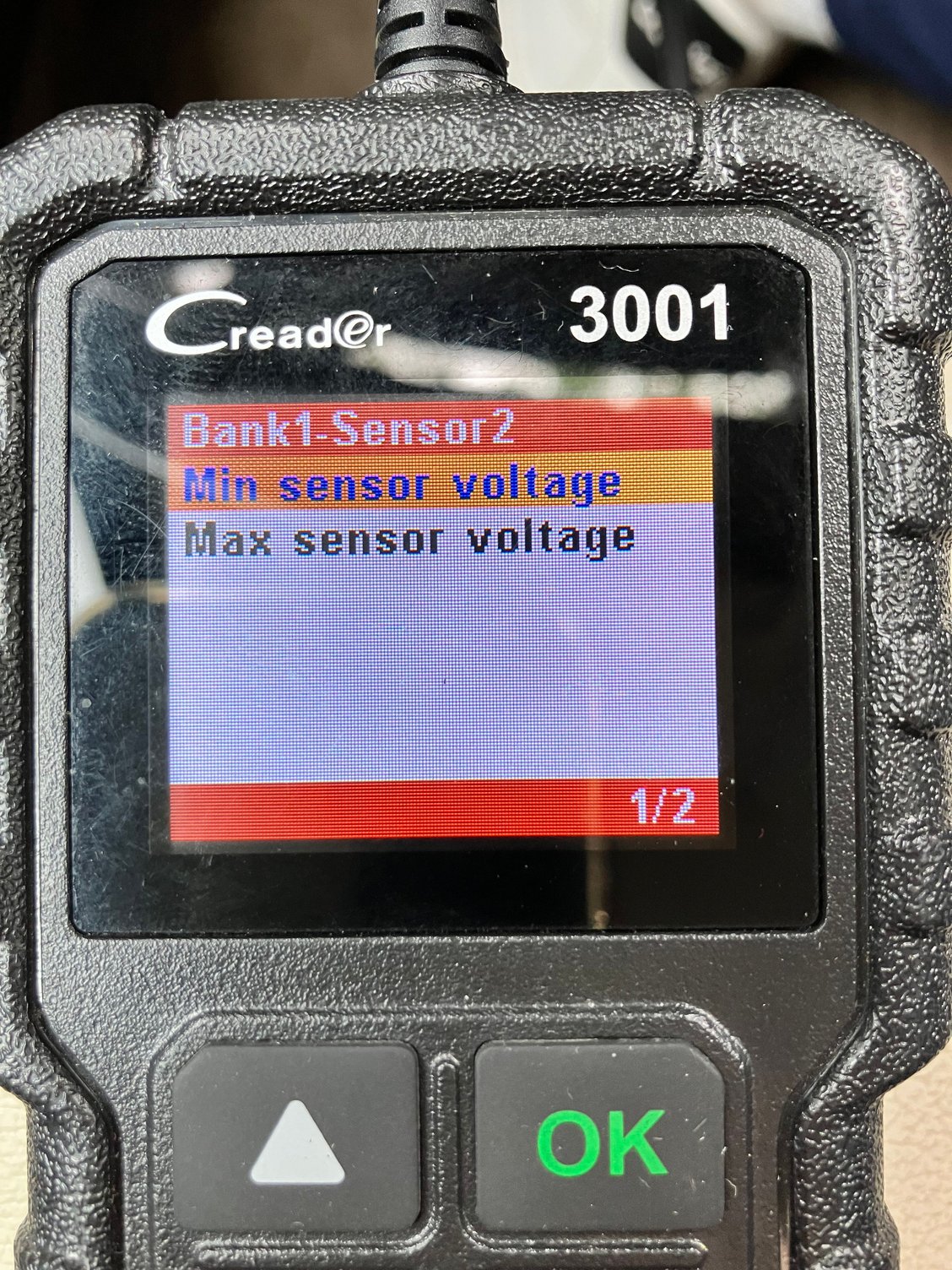

Getting the P0174 code again. Car seems to run fine. Intermittently also getting P0171. Any help is appreciated. I have a code reader that’s not so great. But here’s some pictures of what I’m able to see. Again any help is greatly appreciated.
Old Jun 4, 2023 | 02:17 AM
Blues boy's Avatar
Joined: Jan 2021
Posts: 122
Likes: 17
From: West Midlands UK
May be worth swapping the two upstream sensors over from bank to bank . If that makes the code switch to a fault on the other bank you may have a sensor gone again.
