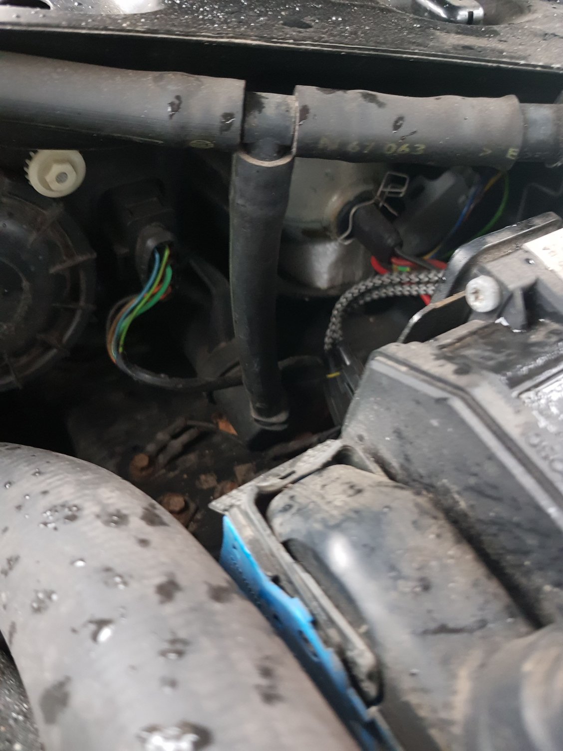

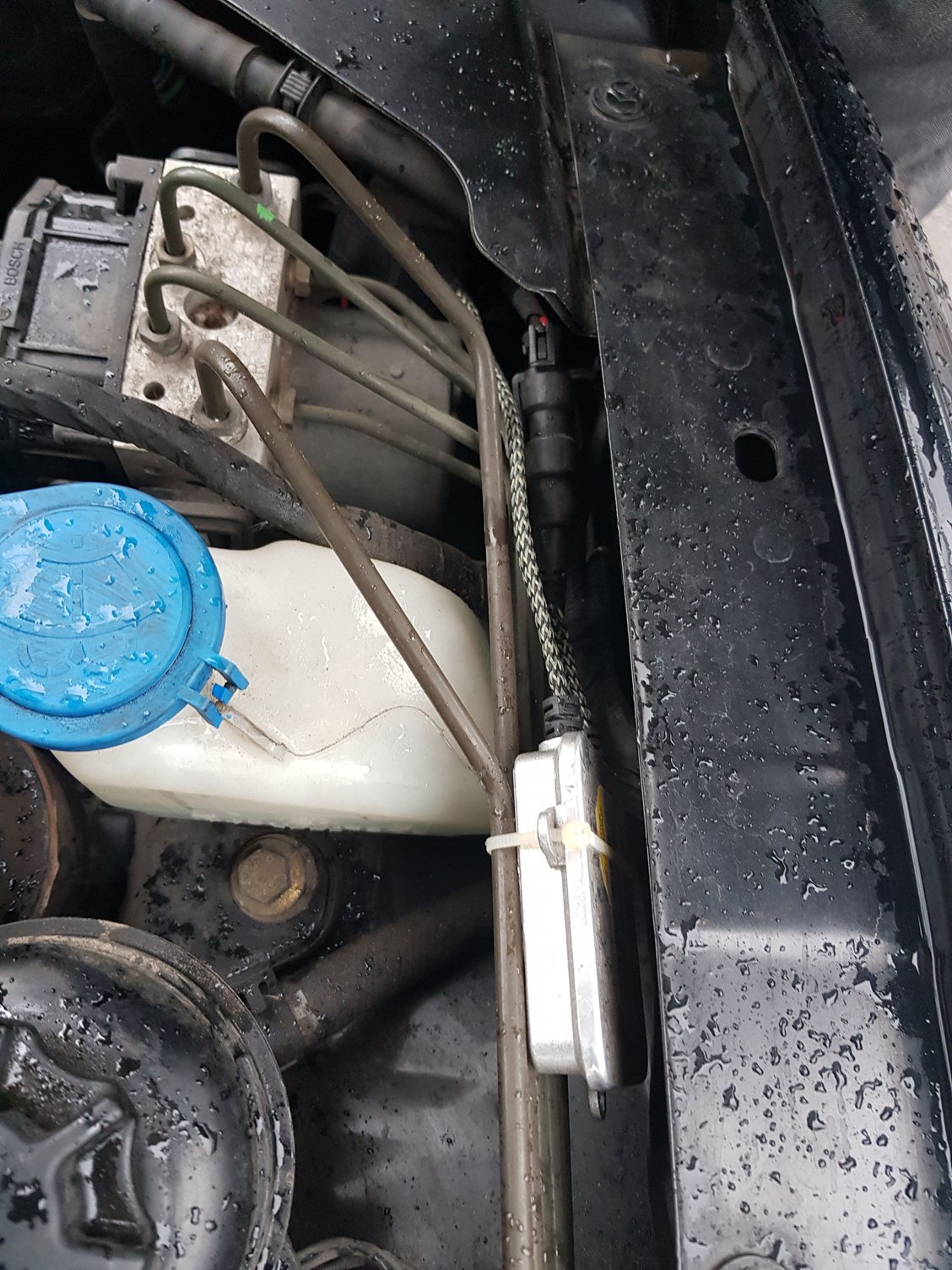

Hi all,
So i purchased a nice jag xtype,2006 model, AWD, 2.5 v6 56000 miles from new full service history, unmarked interior, perfect wheels, the works, it had heated seats, climate pack, sat nav etc, overall i was very happy with the car. Until i sent it for the MOT and it failed.
The failure was 4.15 which i understand relates to the adjusters not working to higher and lower the beam. I understand this can be repaired, however i was happy to stick a new light unit in there, but thats where the problems started, the lights are HID, but Jaguar say they arent because the back of the lights should have a ballast on them, and mine dont, now there is a ballast on the wing each side under the bonnet ive been told the light is a normal unit for my car and its had a conversion, ive been told all manner of different things, so im here for some help.
Can someone please tell me if the light unit i have is the standard light which i understand works with HID bulbs, or whether they are the correct xenon lights fitted to Jag x types?

I think someone has converted your standard headlights to an aftermarket HID kit. My factory HID's are constructed as follows. On the back of the lamp housing is a square box (starter) mounted that holds the lamp assembly. The ballast is bolted to the bottom of the headlight assembly. The ballasts are not tie wrapped to the body works. I can't offer advise for converting back to original and not knowing the maker of the aftermarket unit advise on repairing. Try to find some ID info off of the ballast and maybe we can figure out who made it and then find the installation details to help repair.
The unit as far as I know is a standard xenon and not HID for your vehicle.
It seems youre spot on, having spoken to Jaguar the car originally had standard headlights.
They have given me a part number so i can at least get a new headlight now
