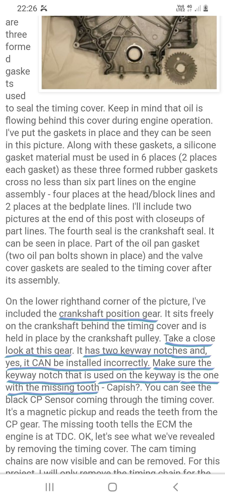

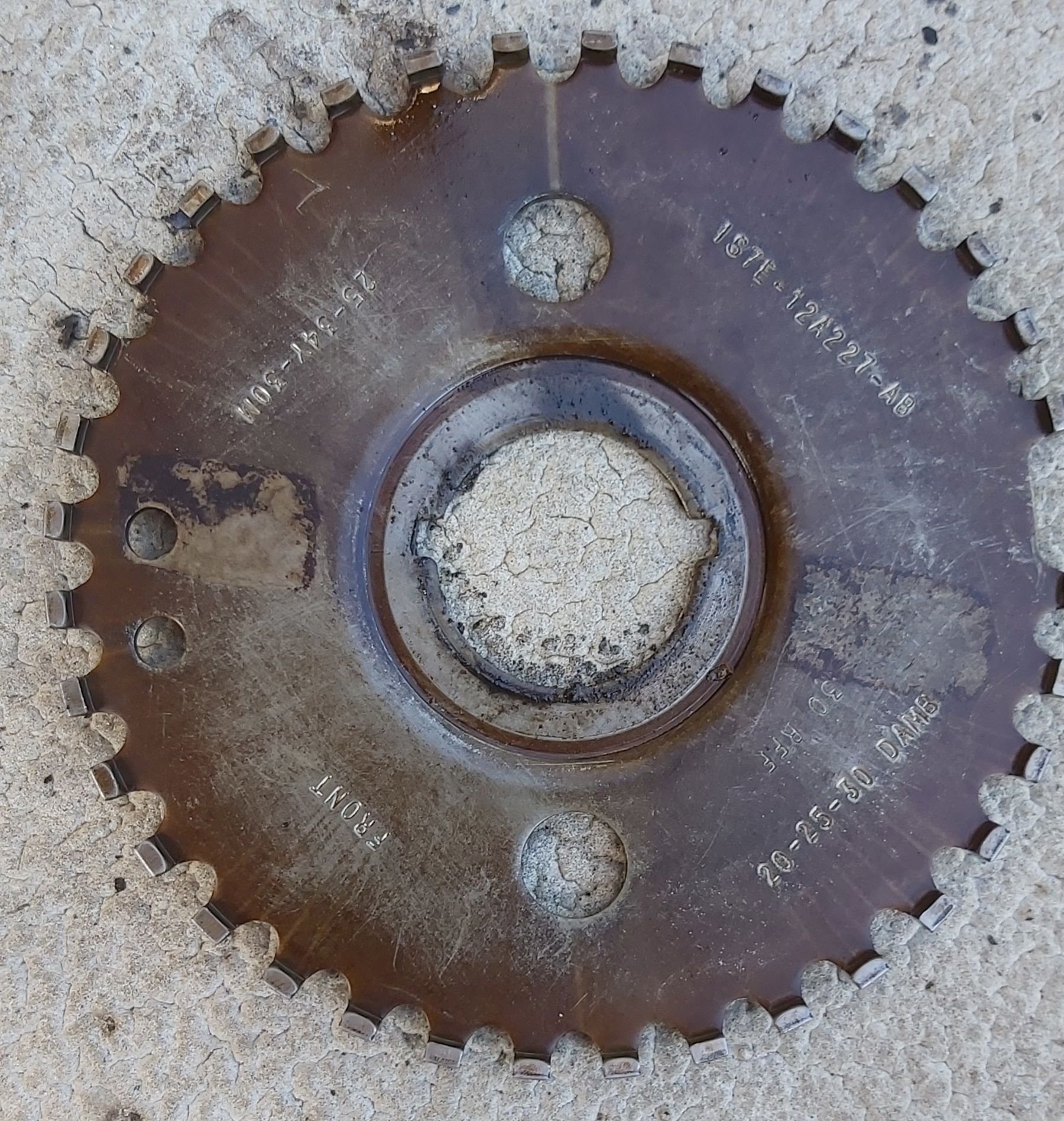

- the crankshaft sensor target disk has two possible sets to be mounted. Has anybody something to say about it?

i found it myself if someone needs it. i found that the right chain was wrong mounted, the guy that change the right hand topgasket had newer out the engine. He got the chain wrong. Now when founding the solution i will come back and write more how ir goes. thanx
