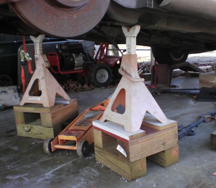

I couldn't lift it up. I had to raise the car and lower it (engine, transmission, subframe) with the cherry picker. I could not get the engine out by itself. I had lower the whole assembly. And I am reasonably convinced that is actually the faster way to do it. My new engine is going back in now. The new one is in, but the car is still up on jacks in my carport. If you'd like to see it, I can snap a picture and post it in the morning.
And now it's morning so here is the picture of the jack stands I used to raise the front. Note I put the rear wheels on ramps for more altitude. The wooden platforms are all bolted together with a through bolt at each corner. Nothing loose. The jack stands themselves may have had enough reach but I didn't feel comfortable with the necks pulled out that far. Thus the wooden platforms. Seems very stable.
In removing the engine, I lowered the engine, trans, and subframe onto the legs of the cherry picker, supported the engine and transmission on each side with a 2x4 inch timber between the subframe and engine on one side and the same with the transmission to subframe on the other side. Then I used the legs of the cherry picker to truck the whole powertrain out from under the car.
My car should come down off the jacks later today. Good luck with your project.
