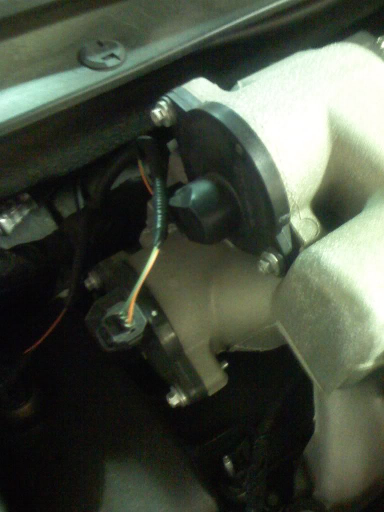

Imt seals - To test, with engine idling, spray some throttle cleaner or brake clean between valve and intake. If idle changes, replace seals.

Agree. Don't do anything with MAF until you check the three following items for splits/leaks (hissing sound of vacuum leak):
#1 - PCV Hose, About 8" long top of driver's side of intake. Check for a split in the bottom of the hose.
#2 - The Brake boost vacuum hose located rear of intake running to the brake booster. Check the brake boost check valve for deterioration on the bottom. (it's the buldging piece in the middle of the hose)
#3 - The IMT valve o-rings. Two large circular on passenger side of intake.
Best thing you can do is have your mecahnic run a smoke test of the intake. It will reveal your vacuum leak(s), and if it's one or more of these, they are relatively cheap and easy to fix.
