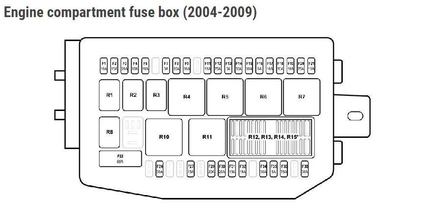

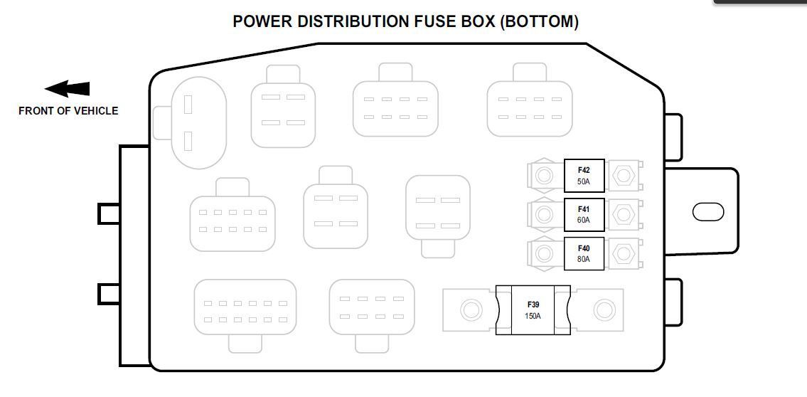

Check the following two fuses in your power distribution fuse box under the hood as both are associated with the cooling fan control module:-
F16 (5A)
F40 (80A) Note: F40 is one of the larger fuses located on the underside of the power distribution fuse box.

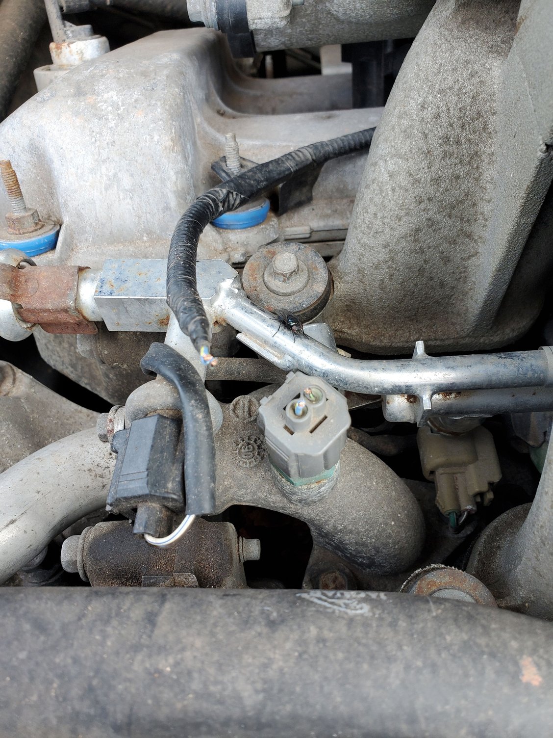

Found this in old thread.

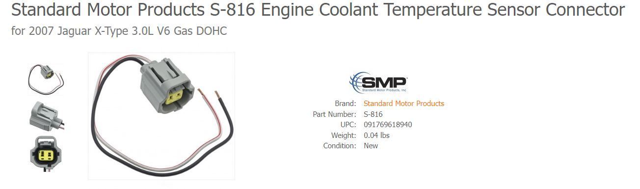

Is this what I need? I think so.

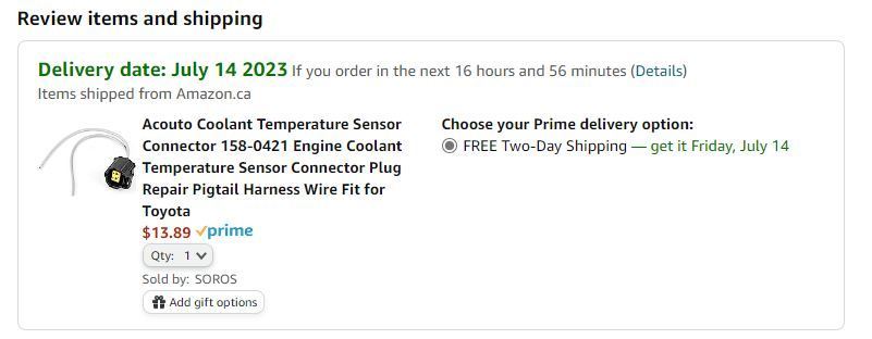

I order this one.

Well guys that was best 16 dollars I every spent. Got the part Thursday. I put in on yesterday Monday morning. I soldered the line together then heat shrinked them. I put it all back in the plastic sheath and wrap it backup in electrical tape.
Took it quick spin before to test. I then put 150 K on it yesterday in the 31 degree heat no issues.
