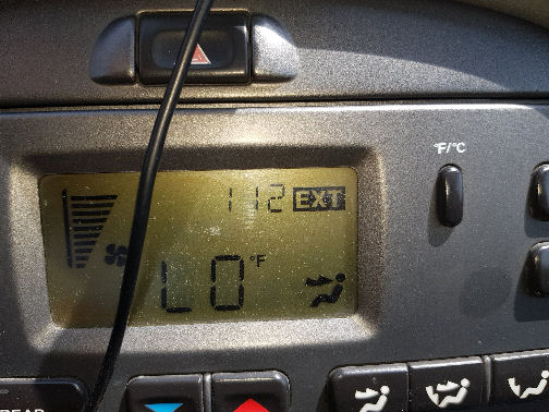

Outside Temp (112F = 44C)
Coolant Temp. (221F = 105C)
