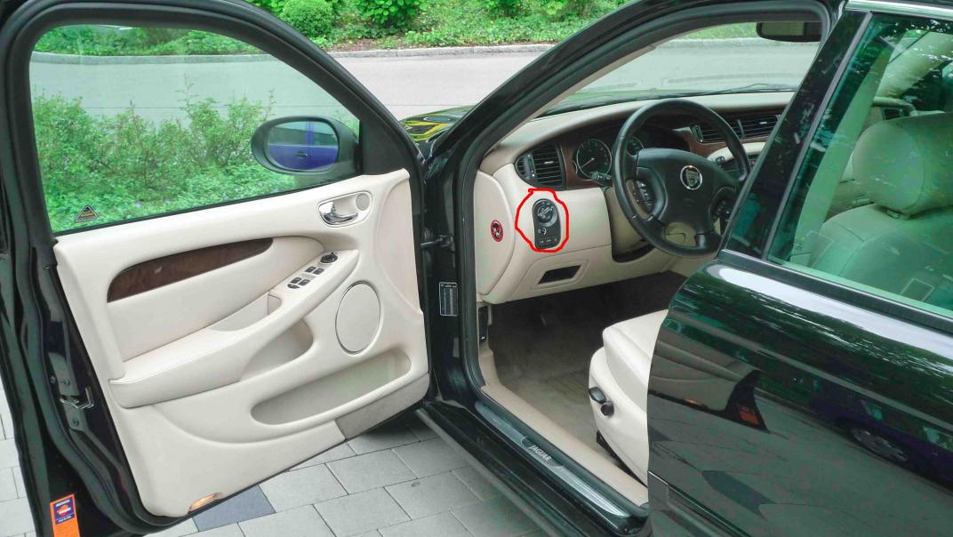

Hello,
how i have to remove this light switch?
Hope for Help.

is a instruction for this in JTIS, i cannot found?
Old Jun 1, 2009 | 03:16 PM
christo's Avatar
Joined: Aug 2008
Posts: 919
From: Chalfont, PA
You can pull the compartment out just below the switch - I'm not sure what it's called but I put my sunglasses there. Once it's out you can see the fuses and all that's in there. Try looking upward or feel around, you might just have to pry softly around the edges and it should pop right out.

Yes remove the panel below the steering which pops out, then put your hand up behind the top of the switch and feel for the top retaining lug, press down and forward jently adding more presure and the top comes forward. then wiggle it all out till you see the connecting cables. remove the connectors then remove the switch
