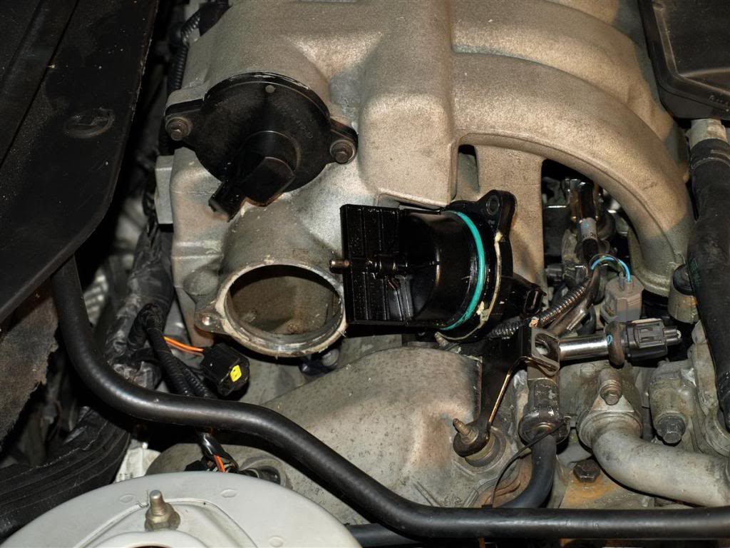

I was able to get them out finally. Thank you all for the input! 1 screw driver under each ear and twist did the trick. Should I be concerned the 2nd one came out? I have not read of this happening to anyone else. I was twisting it around a little to try to get some of the gasket material off and it came right out (the bottom one).
