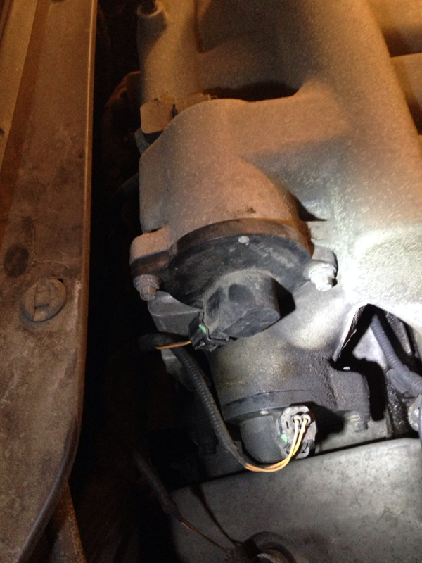

I found an intake leak is there anything I can use to temporarily seal it until I get a new gasket? It's really killing my car on cold start ups. Image is below

Anyone also know what part this is? I believe it's a sensor just not sure which one.

This thread should give you what you need to know. https://www.jaguarforums.com/forum/x...dentify-86849/
The o-rings aren't very expensive - even from the Jaguar Dealer if you have one nearby.

Thanks a lot that helps! I'll have to get on this right away. It's really messing my car up in the morning on cold starts

I was able to get the o ring from the Ford dealer just a mile from my house
