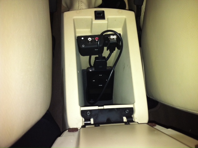

James your instructions are very helpful. For anyone with an ACM or considering one, here are a few observations based on my usage:
1. The latest official jaguar ACM firmware update will allow you to charge and user the iphone/ipod Touch via the iPod connector in the ACM. The older ACM firmware will not charge an iphone - at least not the iphone 4.
2. Installing the jaguar firmware update is very easy and takes only a couple of minutes.
3. There are a couple of limitations with the Jaguar firmware (even the latest one) is that it limits the number of playlists to 5 +1 (All). The screen on the ipod/iphone is also locked so you HAVE to use the Jaguar Console keys to change playlists etc. The other limitation was introduced with Apple's 4.0.2 OS upgrade. With this upgrade, the ipod interface would ONLY allow you to play music via the ipod, so apps like Pandora etc would be blocked from playing through the ACM's ipod connector. An easy workaround for this is to use the AUX input in the ACM and to use the USB connector of the ACM to charge the iphone. In that case the ipod connector is by passed so you can't change tracks using your Jaguar controls. Everything must be controlled from the iphone/ipod Touch.
4. I got around these limitations by upgrading to the Mercedes firmware that James mentions in his page. This update NOW allows you to use the ipod interface to to play back any sort of media - including Pandora etc. However, it has ONE major limitation. You cannot use the Jaguar's console buttons to change playlists. You can only change the playlist from the ipod/iphone.
So, does the Mercedes update applied to the Jag ACM better or makes things worse? Well it depends. In my case, previously I could hide the ipod permanently in the console and do everything via the Jaguar controls. When I wanted to listen to pandora I would connect using the AUX input. Now, the ipod must be exposed to change playlists. I would say that on hind sight I would not have applied this update. However, if I were using only an iphone for the ACM, the update makes perfect sense!
Lastly, the phone bluetooth works perfectly. ACM mutes the audio when a call comes in ....and then starts back out.
UPDATE:
After trying out the 2.2 update (which is designed for Mercedes, but works fine with the Jaguar ACM) I reverted back to 1.09 which is Denison's last official firmware for the Jaguar.
Here is a picture of the ACM as connected in my X Type. I use the ipod for audio most of the time. When I want to use my iphone for navigation/music, I disconnect the ipod connector to the ipod and connect the AUX and USB to the iphone. I am using an adapter from Sendstation for the iphone. With this adapter you get both line out (higher quality audio + charing for the iphone).
SendStation - Products - PocketDock Line Mini Out USB
Another benefit of the ACM is that if you choose you can permanently connect the USB connector to a mi-fi device. It will keep it charged and your car will be a hot spot! Since I have the extra power socket in my glove box, I use that for my wifi hot spot, otherwise I'd use the ACM USB connector since it is powered and does not interfere with the ipod connector playback.
The wifi hotspot has allowed me to use an ipad as the video device instead of using a DVD system. You can stream Netflix movies with no problems! Even can rent movies from iTunes while on the go or watch live TV. I am planning on installing the BMW iPad holder in the back when it comes out. Given that the ipad has a 20 hour video endurance, keeping it charged is not an issue. For audio you can either use headphones or use a bluetooth adapter connected to the AUX input in the ACM.
BOTTOM LINE: I've read many people comment on the disappointment with the ACM, but from my experience it is a very nice little implementation for total AV integration in the x type. If you consider that you can use it to power a mi-fi device (while keeping the device fully hidden and charged) and can connect it to ipod/iphone/ipad or any other audio/video device using various connection options it's pretty versatile....it's more than an ipod connector for sure!
