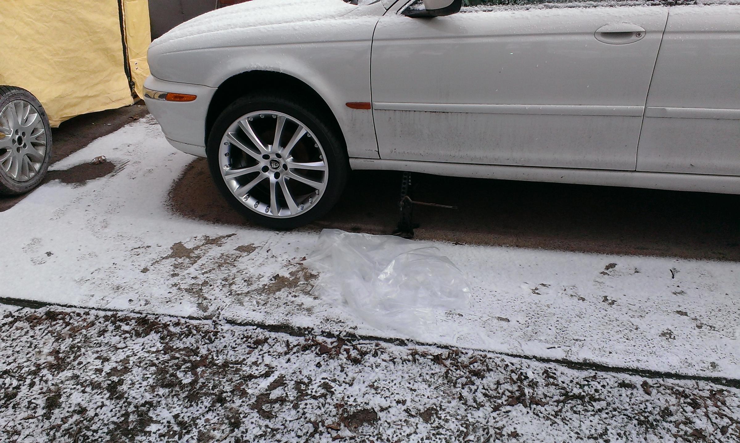

Default going for 20" senta wheels on xtype
So far I took expats advice and ordered 25mm spacers for rear and 5 mm for front im still nervous I ruff fit them with stock 265/35/20 and they hit strut and rubbed well so im going to order new 225 30 20 I hope that will clear strut and well

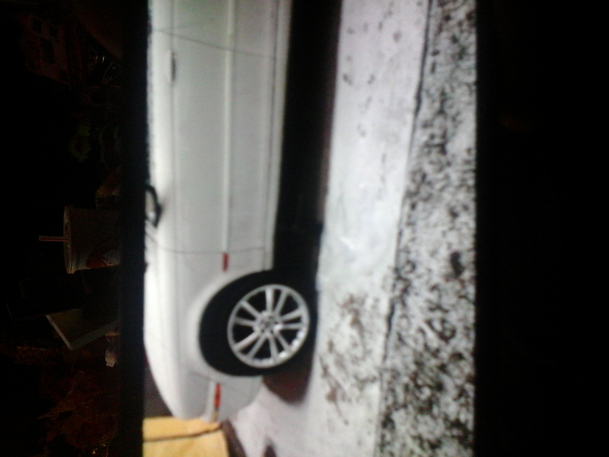

So i tried the front 8.5 on front They clear just bearly with the 25mm spacers i Orestes i tear They are going to stick out too much with 9.5 rears
Originally Posted by exexpat
those will work. You just need smaller tires and to roll your fenders. The rears sit about where mine do.
Thanks im going with 225 30 20 do u think thats good size to go with ?

You might want to go with a 235/30/20 unless you know people who'll mount a stretched tire in the back. My first staggered set were 235/30/20 on all four.
Ok I just ordered seconds set of tires 235 30 20 I will send the 225 s back im just looking for clearance so ill show pics when I finally get spacers and tires mounted thanks Jeremy
