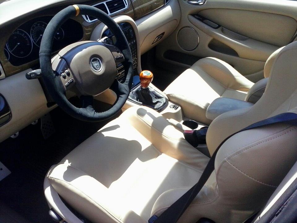

My current seats are really more racy than race, but they are lighter and hold me in place 100 times better. My seats had airbags in them, and I think most do, so now that they are missing my airbag light is always on. There might be a way to tell the computer they don't exist and that its ok, but I just ignore it haha. I had a hard time finding tan seats, and it was either cheap ones like I got, or 3 times the cost of the pair for just one full on carbon fiber race seat that I could get in tan leather and black suede, they are under 20lbs each too haha. I wish I could have gotten those, maybe one day. I will need to replace the ones I have as they are not holding up well to the sun. Oh as for seat tracks, you'll have to custom make them. I couldn't find anything bolt in for the X so I modified the stock seat tracks. My drivers side is still power forward back and up and down haha.
If you really like pushing your car, get better seats. The better the seat holds you in place, the more you can focus on driving rather than sliding around into the door or arm rest haha. I wouldn't even want to autocross with stock seats haha.
Slotted rotors are cool, but they don't really help with stopping distances, they help with overheating and fading, and fading is very bad haha. If you are looking for more stopping power go with good rotors, slotted or not, and the best pads for what you want to do with the car. I recently got some EBC yellow stuff pads for mine since I need to do some brake work. Also look into st225 (focus ST) front brakes. The calipers and rotors are bigger but bolt right into any year x type, but 17inch wheels or bigger are needed. you can get stainless steel brake lines from Goodrich on eBay from the uk. I just got a set so those will go on too when I redo my brakes soon.

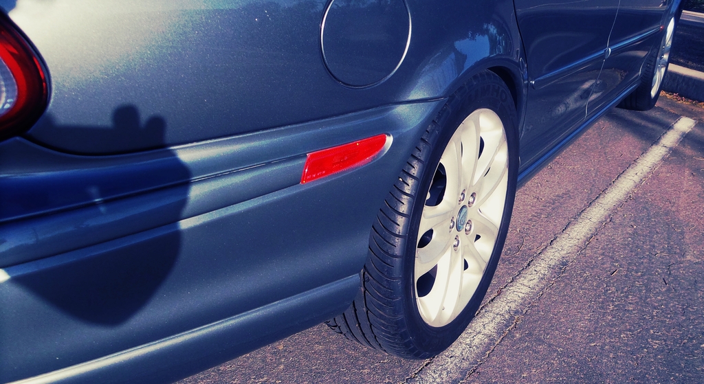

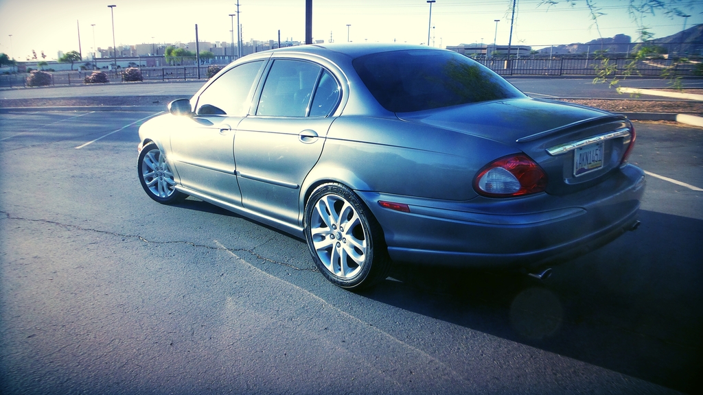

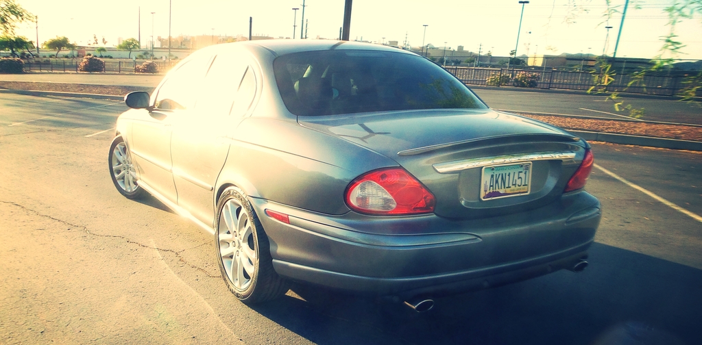

I got a set of 25mm H&R wheel spacers, DRM series, bolt-ons (rear wheels). They are made from an aluminum alloy and weigh 2.5 lbs each. I like the way it looks, esp. with the vehicle already lowered on springs. However, I'm going to have to roll these fenders out to tuck the lip back. As is, I have rubbing on driveways and dips in the road. The driver's side is worse for some reason. Playing it cool until my "fender roller" comes in from Amazon. $75.00. I have a Wagner heat gun, so I'll just get to it; carefully!
The new look is subtle.

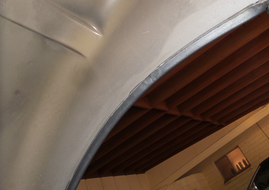

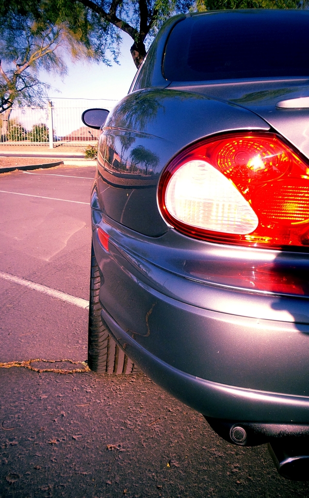

I love the subtle fat look with 25mm spacers. I wouldn't go any wider. I rolled the rear fenders using the Eastwood tool, a heat gun, and a few wrenches. But I'll probably need to stiffen up the rear suspension; been reading JustinK201's suspension build. However, the mods he did on the rear seems like a lot of custom work dude! You've got to give us novices something to work with That thread has tons of good info!
https://www.jaguarforums.com/forum/x...us-far-113706/
The first wheel well (driver's) took a while to roll...But the tire has been getting chewed up on that side the worst, so I started there, I removed the plastic fender well pieces on each side, no problem, 5 nuts each. Heat up the metal to about 200F with a heat gun. aim from the backside so not to stress your clear coat.
learning how to use the tool was interesting, but once you get the angles right and start rolling that lip back, you're in business. The outward pressure/force is controlled with a manual drive screw. Then you use a different screw to lock the angle of the polyurethane roller and start rolling it back and forth. You have to adjust for the different arcs of the fender shape as you roll.
You basically fold and bend the inner lip back on itself like a taco and roll back and forth to a smooth finish. I've heard ppl use a baseball bat to do the same thing. It can't possibly come out as smooth as with a roller.
Tool cost $75.00.
First contact.
Consider the angle of attack.
Start pulling and pushing that roller along the path. Takes some force. Make sure the fender is still warm so the paint bends nicely etc...
The beginning (see the lip starting to fold in towards the bottom).
The fender lip, which is actually two ply of sheet metal, was eventually folded back all the way and out of the way on both sides. I'll have to see how she rides.

The plastic wheel well covers don't fit right any more bc the lip is gone and they need to ride a little higher now to be up and out of view. No big, will glue them out of the way under the fender with a little Liquid Nails or something.
Rides good tho! I'm still pensive about actually hitting corners the way I used to. I was pushing down and bouncing the rear end today and seeing that the bumper cover might be the next thing to get in the way, but I don't think I can do anything about that; unless I could loosen it and pull it 5mm back towards the rear of the car and tighten it.
